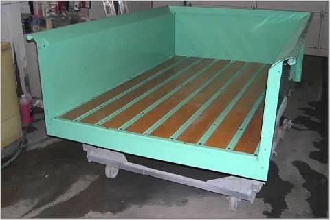

Awhile back I was doing some research on bed wood finishing and I happened upon the Mar-K website where I found some in-depth research/findings on bed wood finishing. A penetrating epoxy was found to be the best as a base...I used the same product that Mar-K used, RAKA epoxy, see wood finishing techniques at Tips & Tricks - Mar-K Manufacturing
I applied three coats of the RAKA and sanded the final coat to remove all high/low spots and then sanded to 800 grit. I sprayed three coats of House of Kolor USC01 show clear over the sanded epoxy...here is what the wood looked like at that point:

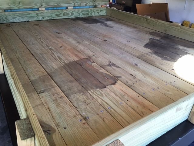

Ash bed wood
20 hrs. of block sanding on 8 coats of Alphatic Urethane .
