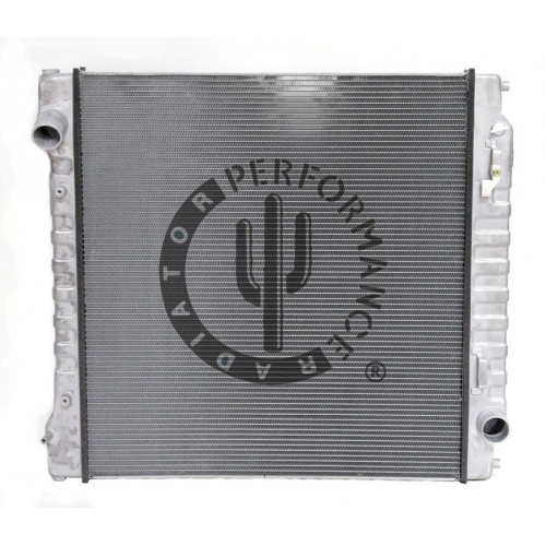

I put this one in my van. https://shop.performanceradiator.com...roduct_id=5296
Performance also makes the one that BPD sells. Plug and play and all aluminum. I don't believe Mishimoto makes one for the vans.

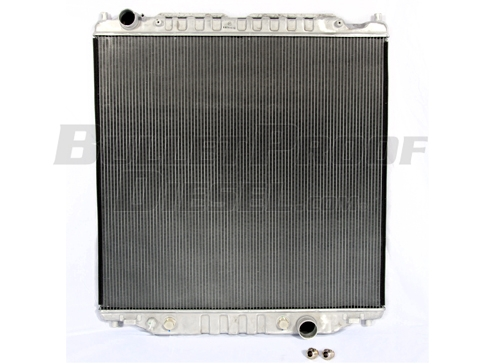

I called Bullet Proof Diesel and they confirmed this is almost the same radiator they sell for the pick up trucks. The sales guy was excited to help me. Told me call and order from Performance. The van has different connections.

USD Price: $204.00
Bullet Proof Diesel Radiator This is for the truck, so price is really not a fair comparison.
Our Price: $369.72
And at almost twice the cost. The one they offer also won't fit the E series. And neither will a Mishimoto. I also checked with Mishi on their CAC boots as well. Basically they don't make anything for the vans.
The Performance radiator has been in my van for over a year. No issues and it bolted right up with no modifications. The welds were clean and no plastic tanks. I've read of fitment issues on some of the other aftermarket all-aluminum radiators on the market. As far as cooling goes, my rig does run a little less hot but I did a bunch of stuff around the same time including a bigger transmission cooler. And I changed to a slightly less aggressive PCM tune from PHP.

I ordered the Performance radiator. My Ford mechanic was less than thrilled. I own 2 Ford vans-an E150 and E350 diesel. Both vans suffered cracked/leaking radiators in the plastic.
On the other hand, I own a 1999 Subaru Outback with 196,00 with the original radiator.
I will give the Performance a good try. If Bullet Proof Diesel recommends and sells this product, I am willing to try it.
