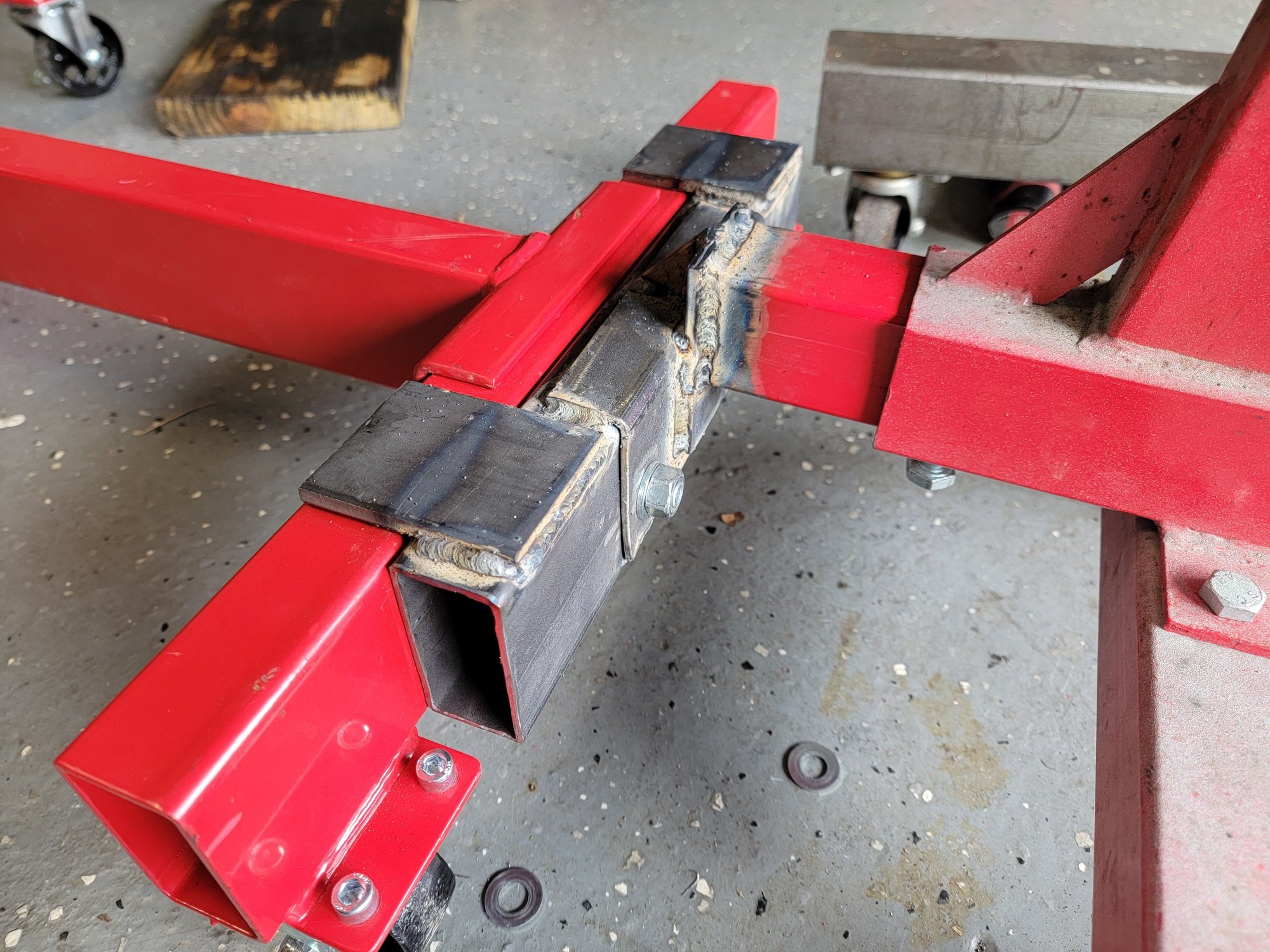

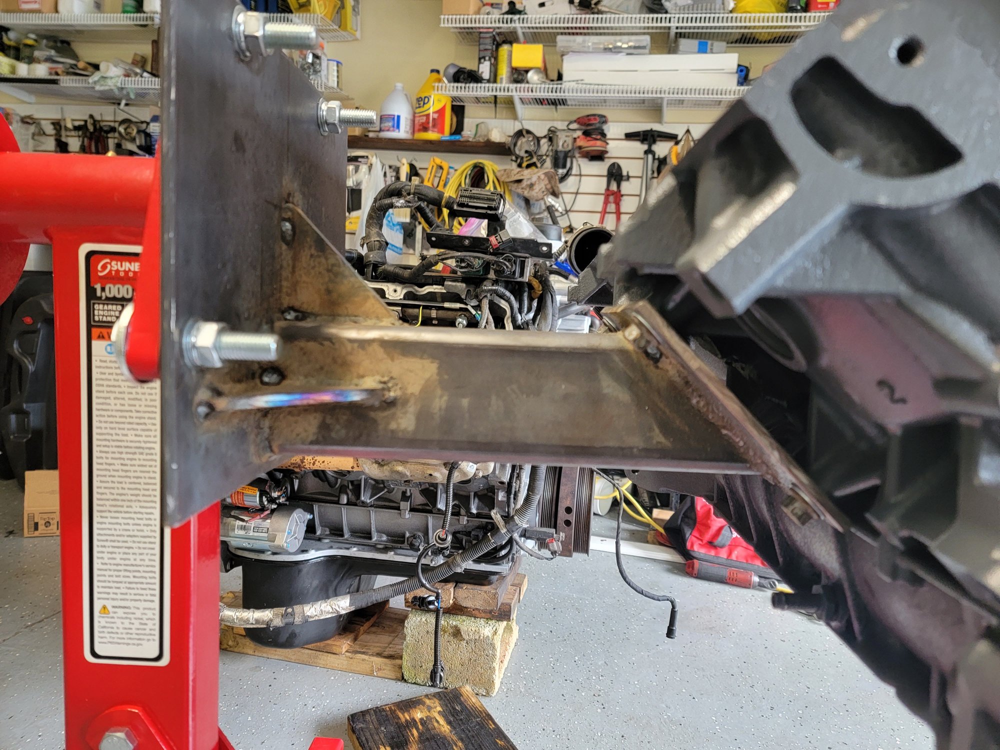

Reviving old thread. Just finished my stand. It ain't pretty but it works. Haven't welded in years and planning on replacing the post on the second stand to one piece with 2 welds instead of 4 lol. Also add a couple bolt on extensions with wheels on the short side for more stability.
Didn't want to modify or cut up the hand crank stand so I made everything bolt on.
got a 1000lb hand crank stand for $200 (retail like $400 or something)
another 1000lb stand for $40
Metal for $130
Can provide more detail if interested.
thanks for the abundance of info. Got inspired by the first post.

lol like I said, it ain't pretty but hey can torque heads on no issues.
