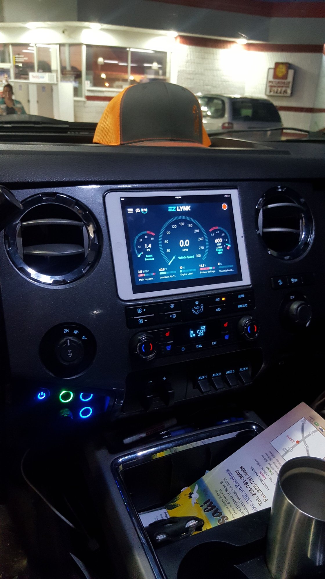

Heres what im trying to do, I have a 2012 F250 with the in dash nav system, I recently installed the I pad dash kit. I left the stock in dash installed to allow me to use my back up cam if needed, but its a pain to remove the ipad every time I need to use the back up cam. My question is would it be possible to purchase a OEM or aftermarket rearview mirror with the monitor in it and hook it up to my factory cam?
