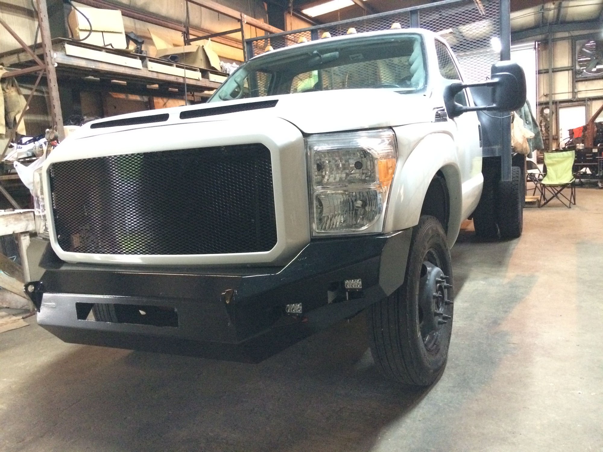

I think we will see a release from KC soon. I'll be 'testing' the KC369 and I think Charlie said the production KC363 and KC366 were also simultaneously in test phase.
You are welcome to come up and help me install it this Friday!
Its going in this truck. (550hp?)
