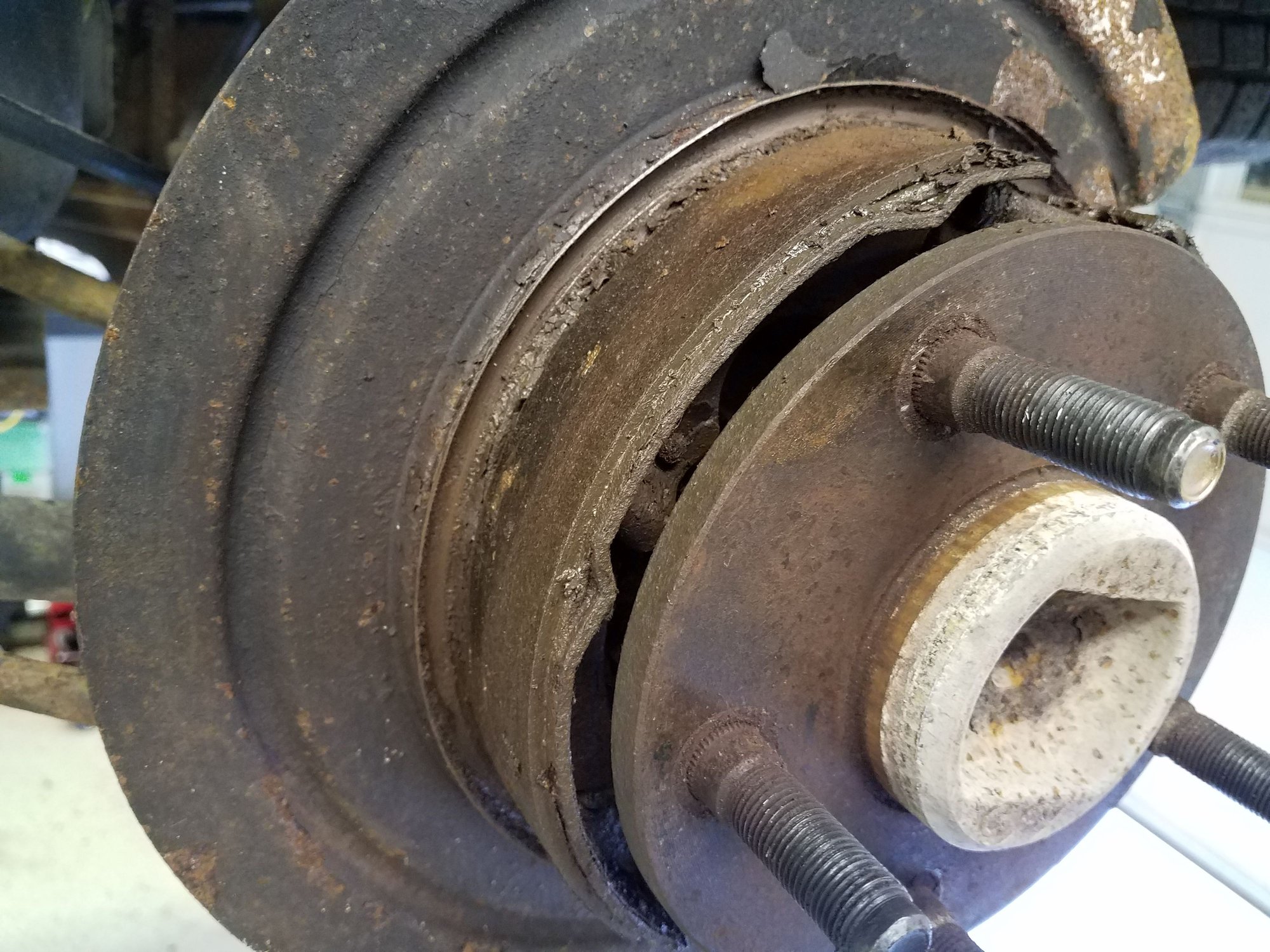

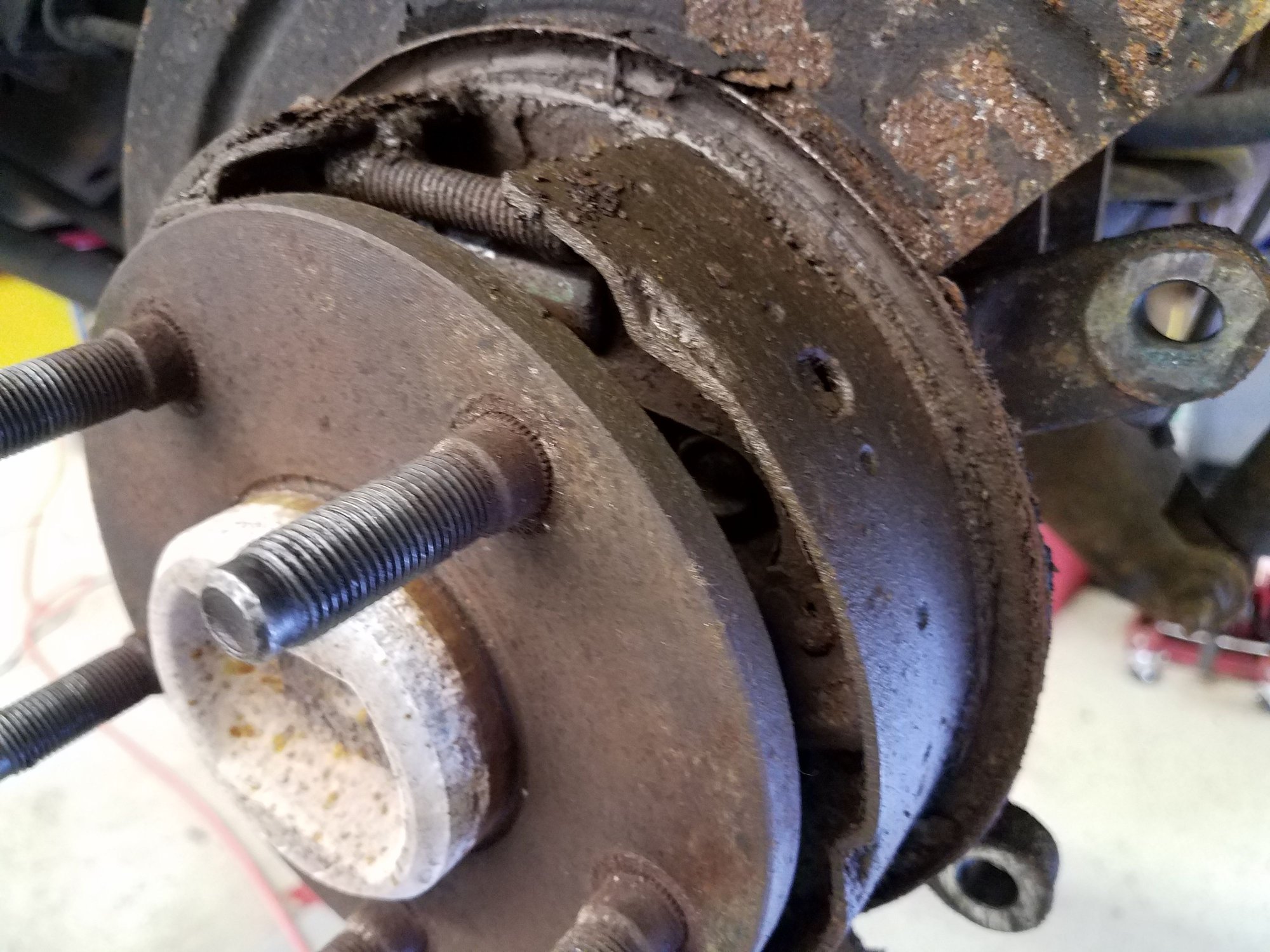

I went to check them out by ohming them. From what I read they should be between 750 and 1500... I get nothing on the front ones (odd that they would both be failed).. So I check the left rear which had been getting a bath in gear oil since the axle seal had been bad (Jake had it replaced). I got nothing there either. I decided to pull the sensor to get a good look at it. Of course it was frozen into the cast iron bracket and broke (yes, I was being nice to it too - lots of PB Blaster - not prying like a gorilla etc. So I decide to pull the wheels and get a better look. Whoever put the wheels on that car wanted to hurt the poor guy that needed to change them next. It took my 3/4 drive CP Impact wrench with a full head of pressure at the compressor to get the lug nuts loose. Then to make things REALLY interesting - All 4 alloy wheels are frozen to the hubs. It took a lot of convincing with large pry bar and 5# dead-blow..
Back to the left rear.
I get the caliper off and its bracket. The rotor was a couple hammer blows to shock it loose (normal).
Rotor off now and I'm looking at the worn our brake shoes from the parking brake and a bunch of shrapnel around the inside end of the sensor (which I apparently never budged).
So I will be ordering that sensor at the very least - along with new shoes and hardware for the parking brake ... Oh and a new pinion seal - I hate leaks...
I'd like to know what you think about those front sensors not ohming out at all. All of them ohm as open circuits - even on my good Fluke autoranging meter.
