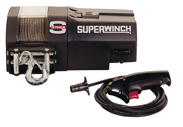

Mines the 4500 Superwinch(not 4000). I've googled it and don't find it anymore. They show some ATV winch with fabric cable.
This is what I bought in 1996 and still works perfect to this day after thousands of pulls:
I bought the Ramsey remote control for it years ago after fighting with that cable switch they come with. I had lengthened it to reach the car at the bottom of the ramp but got tired of running it over and getting tangled up.
Ramsey Wireless Receiver and Transmitter Kits 282058
Summit $106.
I've had that for 15+ yrs and still haven't replaced the battery in the remote fob. I'll likely jinx that now.....
I have it wired to the TWO deep cycle batteries in my trailer. I used one battery for years, but with the added accy's I've put in the trailer, some three day events the winch would get weak at the end. So I put two batteries and it has no problems now. I typically get 5 yrs from them, I have a trickle charger attached to them and plug the trailer in while at home and all winter long.
