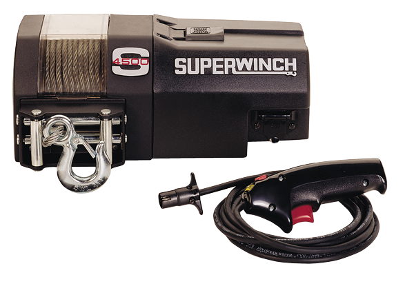

Get a GOOD winch. I've had my 4500 Superwinch since 1997. Works flawless, every weekend for 20 yrs. I got a Ramsey remote fob for it, makes it nice not to have to deal with running over a cord. So many I've heard just love their Harbor Freight winch, but don't use it regularly. Mine gets 4000# put on it every weekend. I can't find the 4500 winch I have, seems they don't offer that style anymore? They offer a 5000# model.
Mine looks like:
This is the remote:
https://www.quadratec.com/products/92142_100.htm
Mount it to the floor and back it up with some plate on the other side or tie it into a crossmember in some way. You don't want it pulling through the plywood!
Wire it with BIG cable. Battery cable sized. Anything smaller will limit the current(power) and will sacrifice pulling capabilities.
Mount the battery in a box (or outside in a box ). A nice group 31 sized battery. Anything smaller will just limit your time available before charging. Think about putting a solar panel on the roof of trailer to charge it while parked. I plug my trailer in all week, so I have a trickle charger bolted in the trailer to charge the batteries
