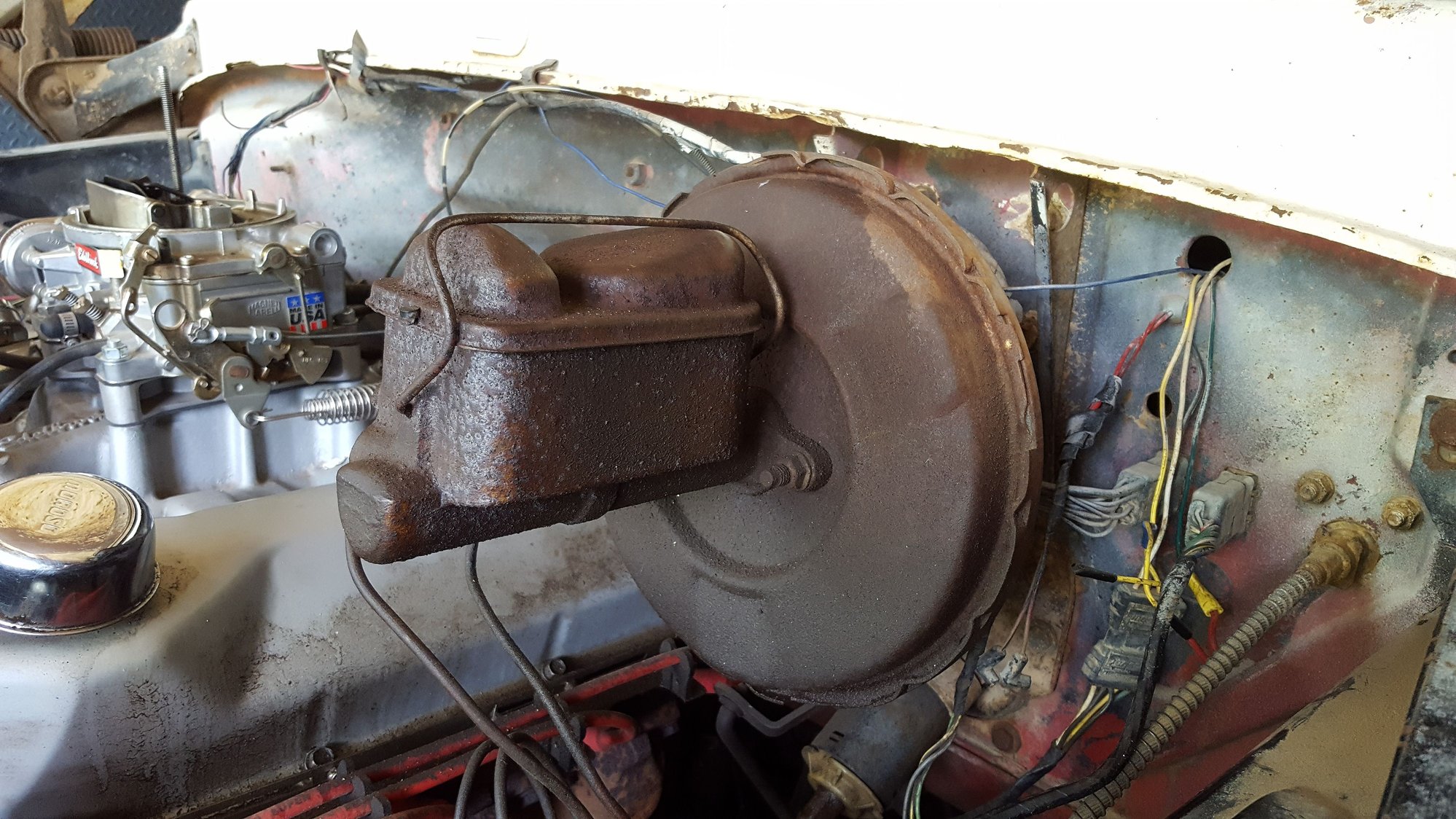

Can someone give me a part # ,or tell me where to find one. I would assume this is a "79" mc/booster. I looked a "79" up and there are several different models to choose from.
1979 Ford F150 4x4, front disc brakes, 351M, C6 automatic.

If anyone has theirs apart, can you check the length of the pushrod also. Mine is about an inch short and there is a funky diy bracket.

Originally Posted by swoosh1958
Can someone give me a part # or tell me where to find one. I would assume this is a "79" mc/booster. I looked a "79" up and there are several different models to choose from.
D7TZ-2005-A .. P/B Booster-Use without Speed Control / Obsolete
1977/78 F100 2WD & F150 2WD/4WD; 1979 F100 2WD & F150 2WD/4WD before serial number DJ0,001.
1977/78 F250 2WD w/single piston caliper disc brakes; 1979 F250 2WD w/single piston caliper disc brakes before serial number DJ0,001.
D9TZ-2005-C .. P/B Booster-Use without Speed Control / Obsolete
1979 F100 2WD & F150 2WD/4WD from serial number DJ0,001.
1979 F250 2WD w/single piston caliper disc brakes from serial number DJ0,001.

More Information for A-1 CARDONE 503703 http://www.rockauto.com/en/parts/a-1...e+booster,1884
Will either of these work?
