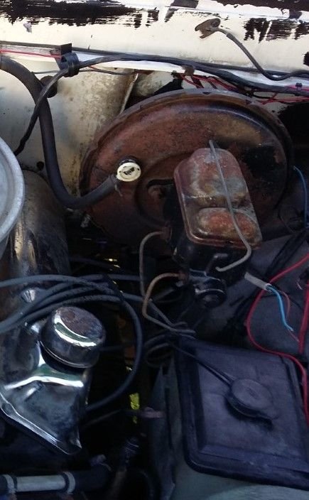

Hi!
I need a new Master Cylinder Cap but I think it's difficult to find one for my -77 Truck. (4x4, PB, Front Disc Brakes)
There are a lot of different Master Cylinders out there but I dont know if most of them uses the same gasket and Cap?

I doubt it would be difficult here in the US to get one from an auto parts store. The problem is, you aren't in the US
D6OZ-2162-A .. M/C Cap / Obsolete
1976 F100/150 2WD/4WD / 1976/85 E100/150 / 1976/86 F250 2WD w/single piston caliper disc brakes / 1977/83 F100 2WD / 1977/86 F150 2WD/4WD
1976 Torino/Ranchero / 1977/79 LTD II (not an LTD!)/Thunderbird/Ranchero/Cougar.
There are 15 available NOS, but I don't know if any of the sources will ship "across the pond" to Sweden.

D4AZ-2162-A (replaced D6TZ-2162-A) .. M/C Cap / Obsolete
1976/79: F250 2WD (with dual piston calipers) & F250 4WD & F350 & E250/350.
1974/75 LTD/Marquis / 1974/75 Thunderbird/Cougar with rear drum brakes.
GREEN SALES CO. in Cincinnati OH has 13 = 800-543-4959.

Thanks, once again ND. Yes, at least some of them are shipping overseas.
A couple of years ago you helpt me finding some parts for the shifter (aut trans) for my F100 -56 and Green Sales shipped without problems. Thanks!!!
