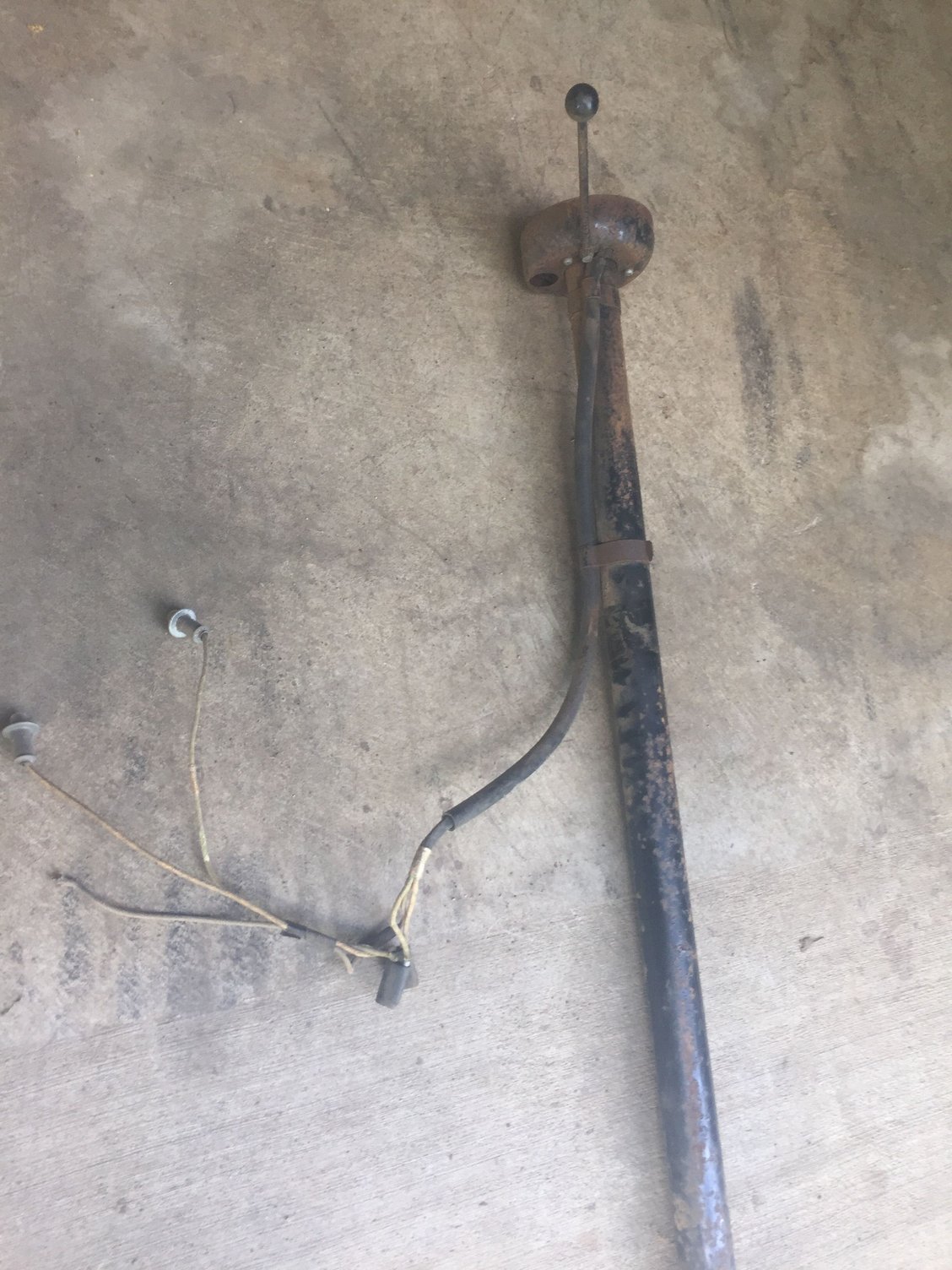

Could somebody post me a photo of a factory setup?
Thanks!

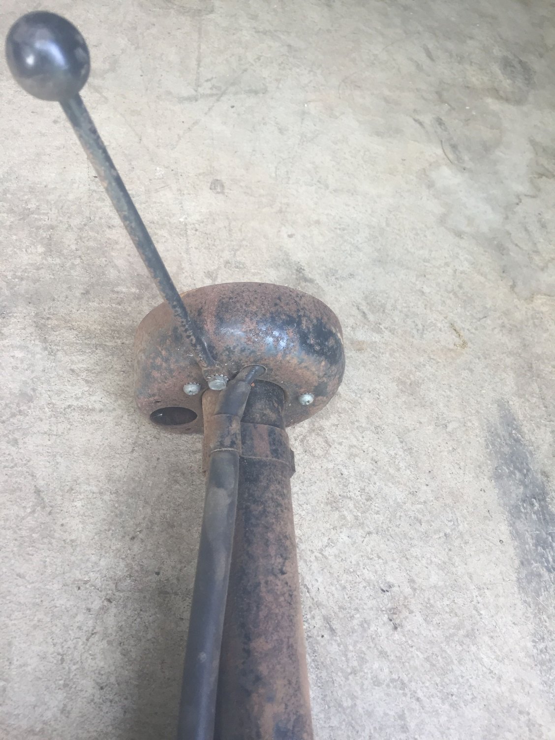

Take another picture of your column from the top looking down towards floor.
There will be 2 larger holes on left and 2 small holes, I can see 1 0f the small holes in this picture.

Oh, I was looking for the holes on the side of the cup not in the bottom.
Thanks, it's clear now!
