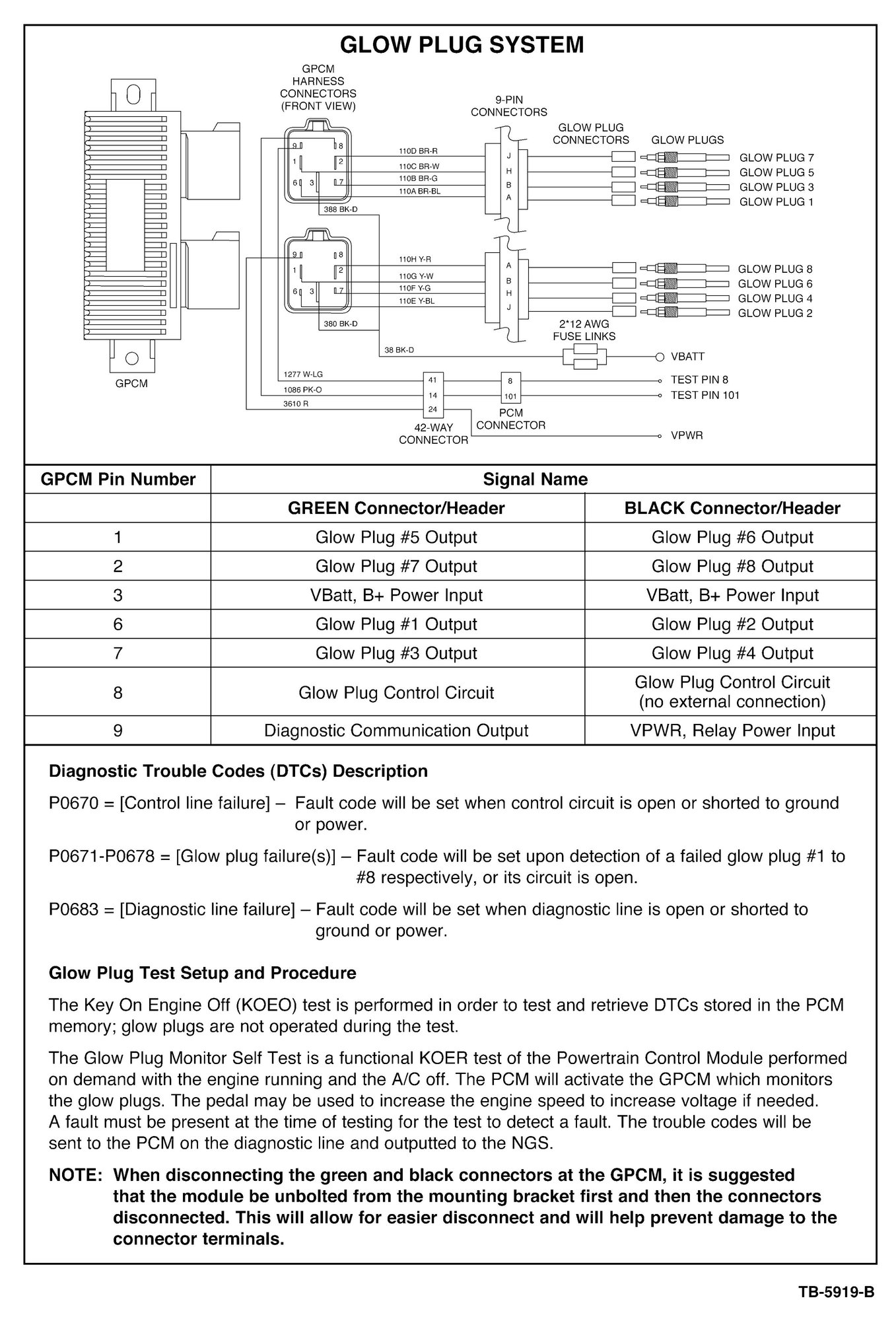

I feel your pain. I have been chasing the GPCM codes since I bought my truck. The difference is mine is running fine and the glow plugs are working. I believe my problem is the wrong PCM in the truck.
Here's a link to my thread if it helps: https://www.ford-trucks.com/forums/1...dule-test.html
And a diagram I found useful but you may already have this.
