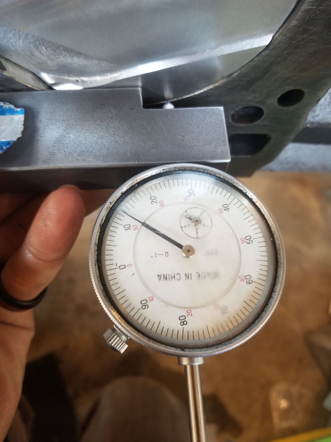

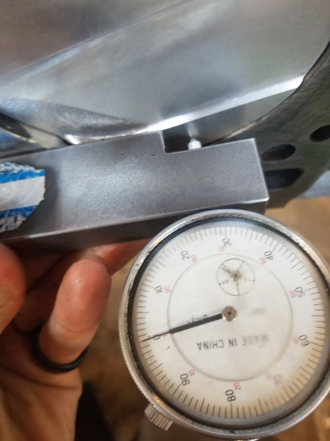

Now I'm a little concerned. I used a sledgauge to check the piston and it comes up .011 below 0deck. Any help would be great.

No reason to be concerned with 0.011 below deck.
Now fit the remaining pistons and measure their deck numbers.
Once you have all 8 numbers, remove all 8 pistons, but number them 1 to 8 for re installation later.
You can then have the decks milled to give you EXACTLY zero clearances.
Trust no one, and oversee the milling machine setup and milling !
This is actually the correct way to build an engine although right now it probably seems like a nuisance.
You fitted the rings, checked them, removed them, filed them, fitted them, checked them.
It's the same principle with the pistons and deck clearances, except that you only mill and re fit once.
Ensure that the block is cleaned thoroughly once the milling is finished.
I don't think 0.011'' or thereabouts will cause issues with push rod lengths and intake manifold fitment, but double check with Tim.
Remove the crank and cam too before milling.
OR :
Accept the deck heights, and continue to build.
The engine would run fine, and you'd pass your exam. No distinction, and you'd know you cheated. LOL
By the way, is that the new spelling for 'USA' on that gauge ?

it was a Meracle that I heard from Tim yesterday, he suggested that I just put it together and run it although the compression ratio is going to be a little bit lower in then 9 and a 1/2 to 1.
If that's the case then I will just put it together today after I get home from dropping my mom off the airport, it's a nice hour 1/2 drive 1 way to get to the airport

Your SCR will be 9.2.
If you assemble the engine the way it is, I'll be the first to stop talking to you.
Rather do it properly !

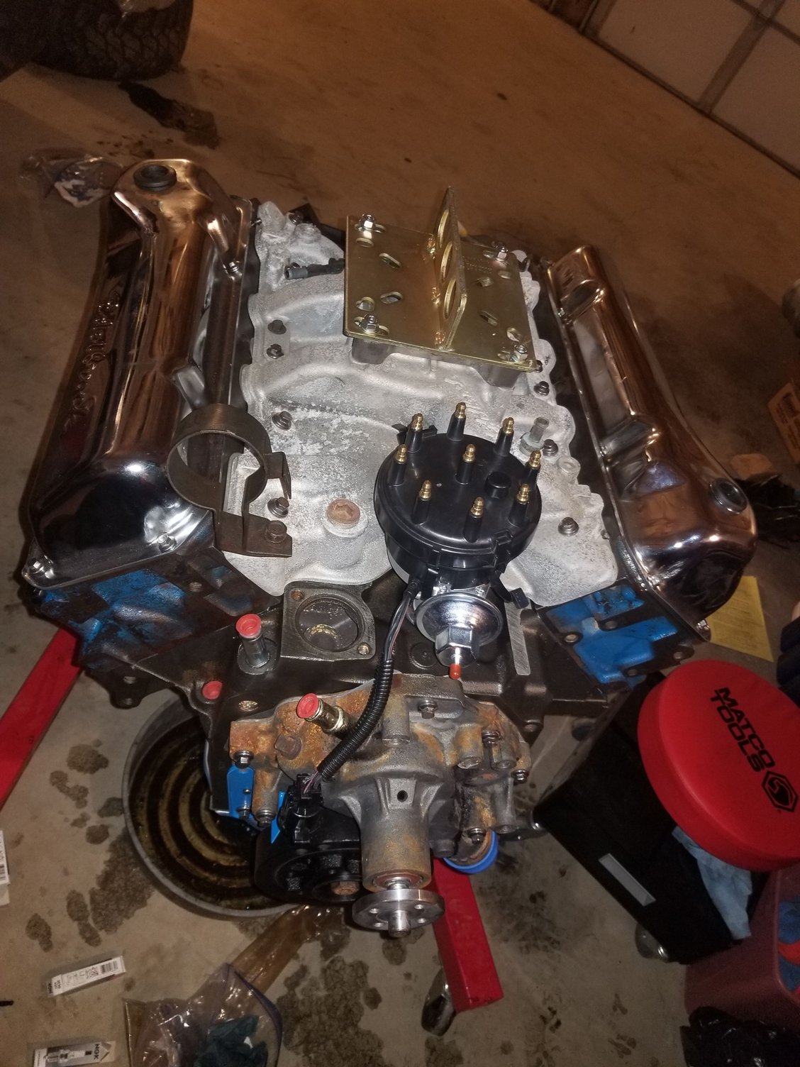

i got it taken care of, sorry for the late reply. it got really busy.... and i just graduated on the 11th.... so it was busy! i got it almost put together... and i just got my push rods from tim. and the last thing i needed was the last thing i needed! the oil pan and oil pump is on, i have perfect valve clearance, and the rocker arms are shimmed perfect middle to middle. and the rocker arms are on and ready and the roller tappits are soaking in oil so they will be ready!

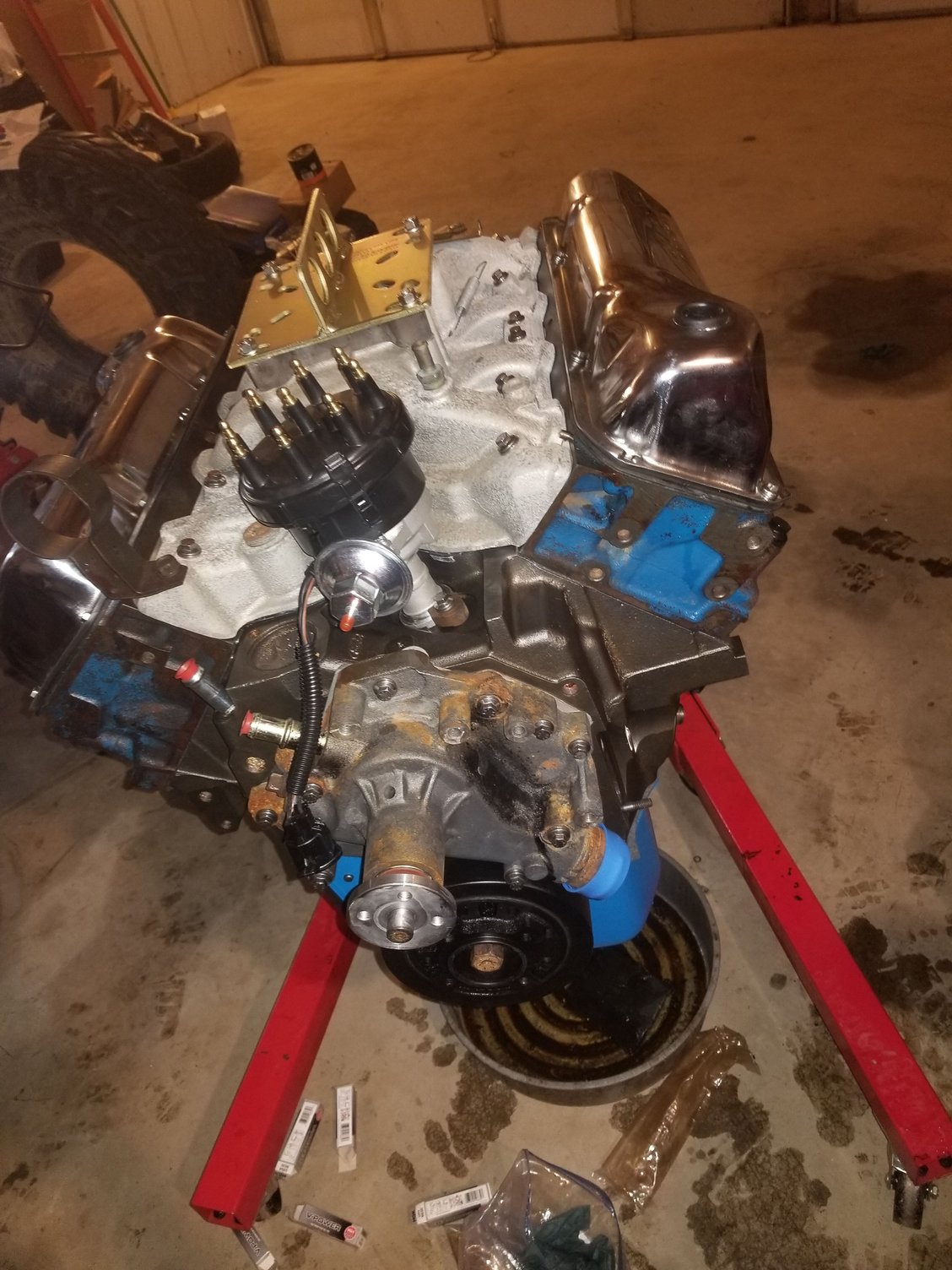

Old May 17, 2018 | 11:19 PM
  #60
FMJ.'s Avatar
FMJ.
Joined: Aug 2016
Posts: 723
From: Cape Town, South Africa
An artist at work !
I like those roller rockers.
