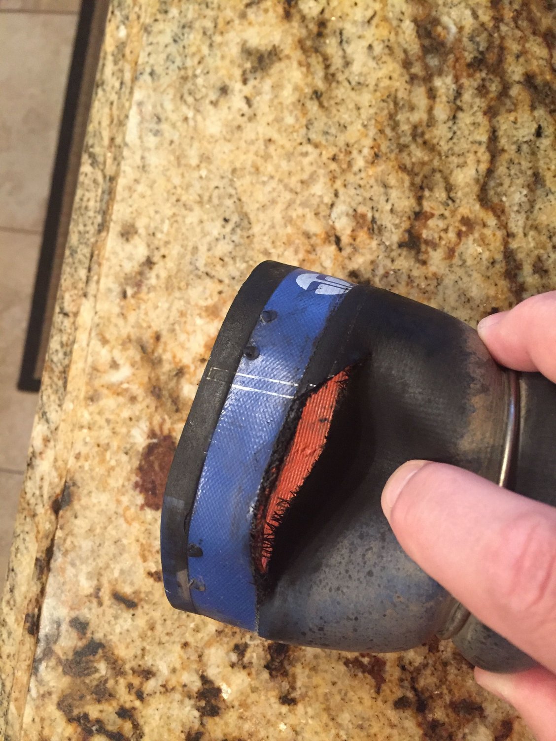

I replaced the EBP sensor, bought a new MAP sensor, was about to put it on and I decided to crawl around the engine bay.
Looked under the truck and the hose connections were fine until...I noticed some dripping on one end of the intercooler hose, the side closest to the radiator.
The truck was cold so I reached up and grabbed the hose, I could see that there was a split in the top of it! Had I not squeezed that thing I never could have seen it. The tear was on the top side and nearly impossible to get an eye on.
Went to the stealership, $100 later have a new hose and the truck runs great again!
The small oil drip got my attention. This is the bottom side of the hose that looks just fine
Here is what I had after removing it. About a 2" tear on that thing!
