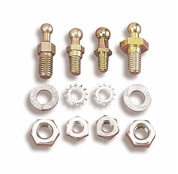

I bought the Holley kit, know have to get some of the ball connectors...
Holley makes a ball stud assortment kit. Part number 20-2. One of the ball studs in it will do it for you.
Holley 20‑2 Carburetor Throttle Ball Assortment Kit

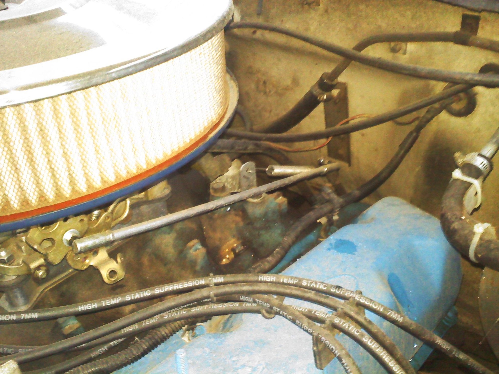

Originally Posted by 72CC428
Hey Jeff. That rod you show in the pic. Where can I get one? I can't find the one I had anywhere in my parts. I have a Carter AFB and it has the ball studs. Also, do I need to know the size. Just from vague memory I would say mine was close to 8 in. long. That sound in the park for one of those?
The one in my pic I had fabbed myself. I went to Ace hardware and bought the stuff.The ends came with the ball studs in them. 2-ends, one piece of all thread, and the aluminum tube you see over the all thread to cover up the threads. As you can see from the Holley 20-2 kit above there are different ball stud sizes. I think all the manufacturers used the same size though so the above mentioned D5TZ9747B will prolly work for you also. That D5TZ9747B is adjustable not a fixed length.

It together with the rod will come together on that D5TZ9747B Chris.
