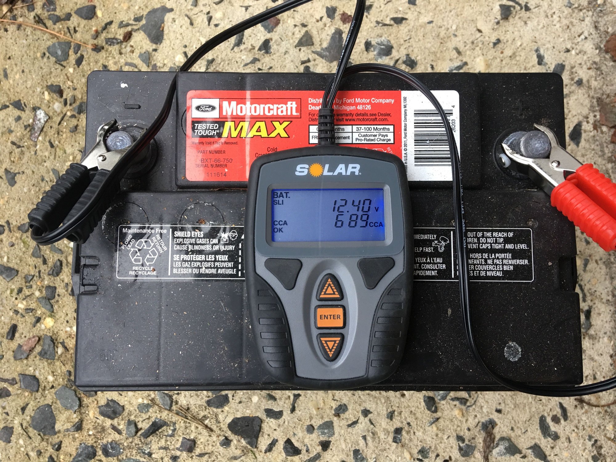

At your overnight temps, the volts you spec'd are low, although those of us without Military grade batteries like Mark has will see volts that low even with good batteries in winter.
Do you know the size of the batts and what they tested to? Here's a picture of a battery I just tested for a video where it still reports as good but is very much hurt. Powerstroke 6.0s tug a lot of energy out of batteries more then other motors.
You're reporting volts in whole numbers, as though 12 is fine, but it's not. Tenths matter with batteries and a battery that reports 12.2v rather then 12.6v can be a really hurt battery. However, still not sure your problem is glow plug related.
