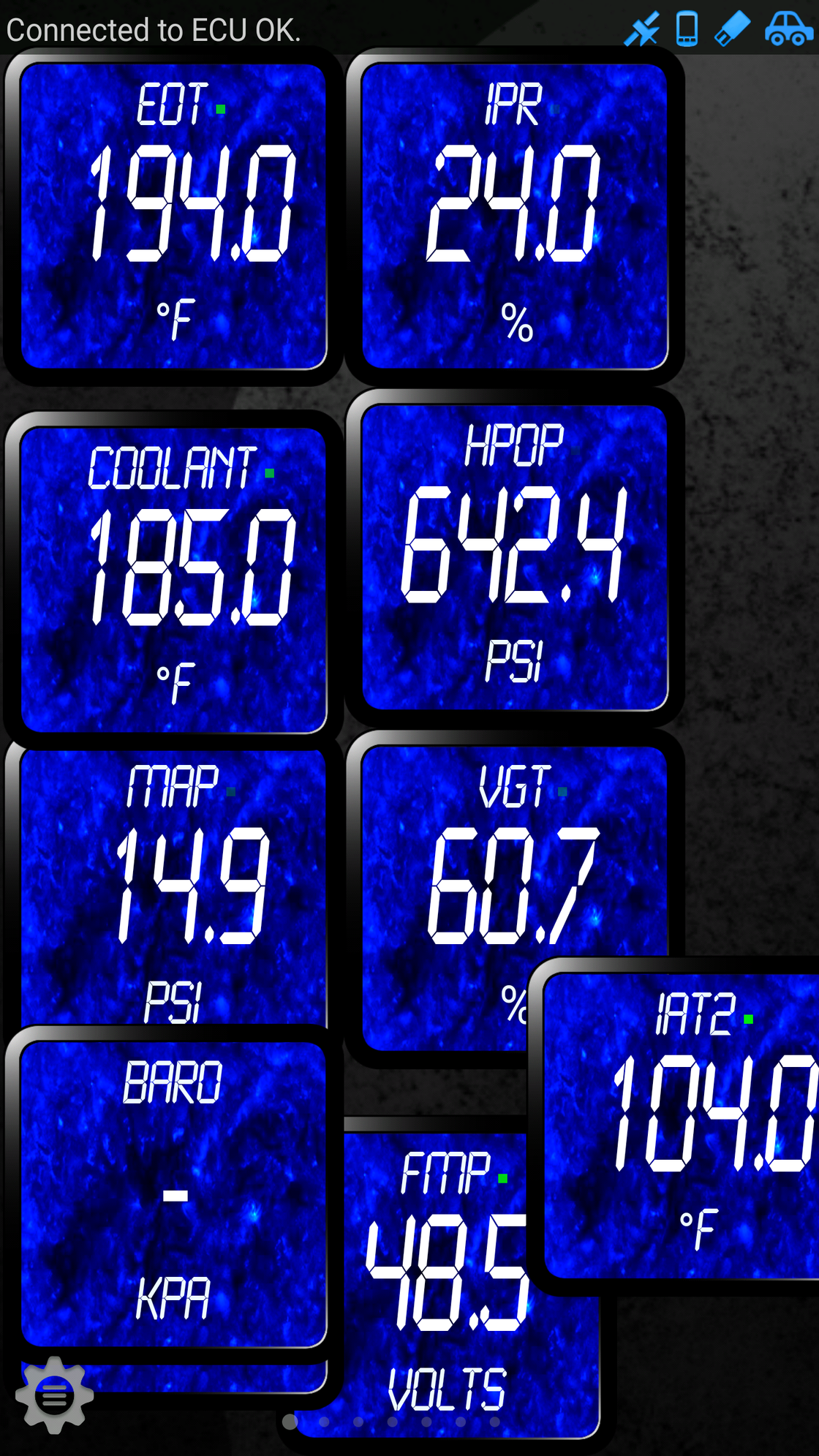

Just got off work... parked downhill. About 70° outside. Started 1st turn and chugged a little then smoothed out.. driving 30min home then will repost after warmed up info
Old Apr 10, 2017 | 07:33 PM
Big Red trucker's Avatar
Big Red trucker
Joined: Jul 2016
Posts: 85
Pic above post is cold idle

Why aren't you getting a Baro reading?
Glow plug operation is connected to that reading.

Honestly not sure, just added baro. Never have used that reading

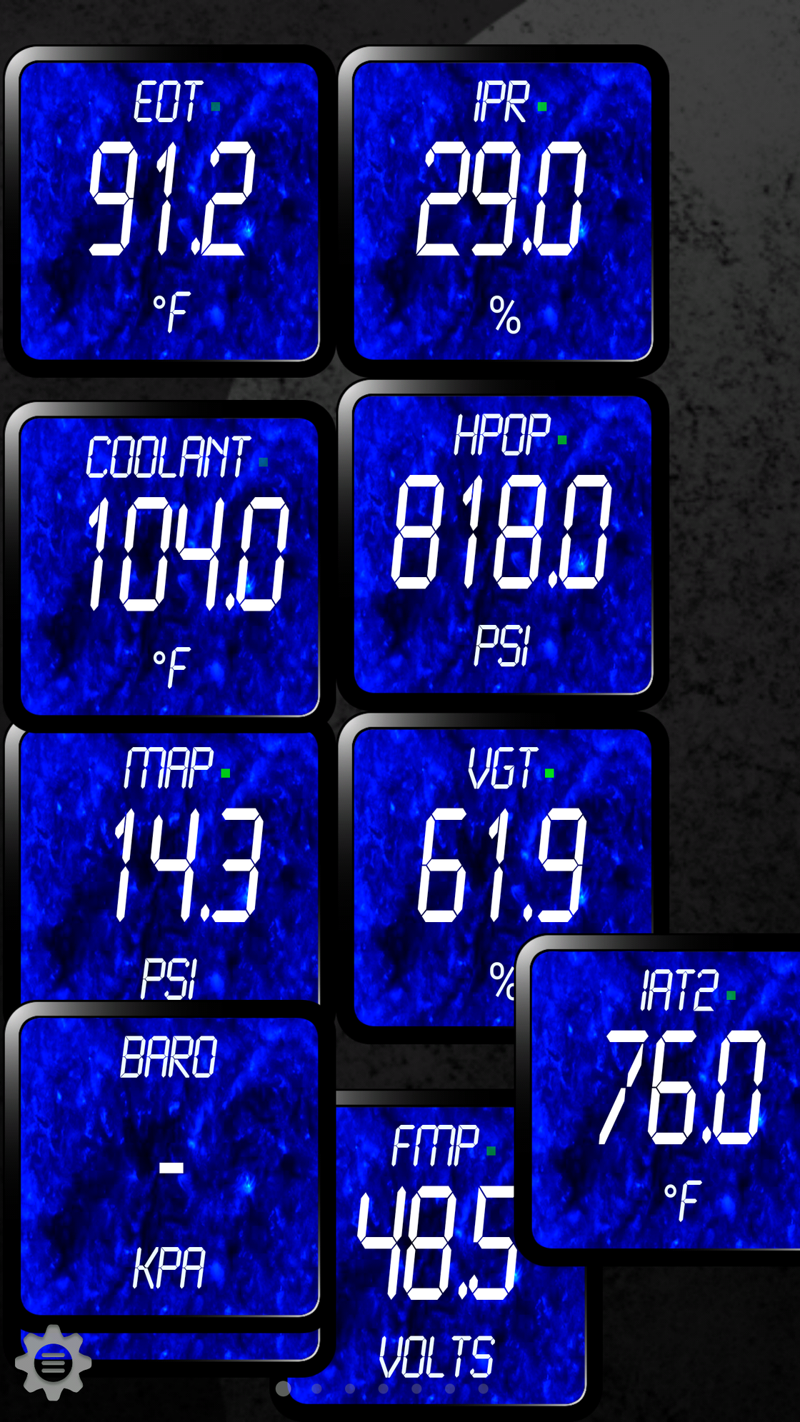

This is hot reading

Check your Baro sensor and/or change it out.
