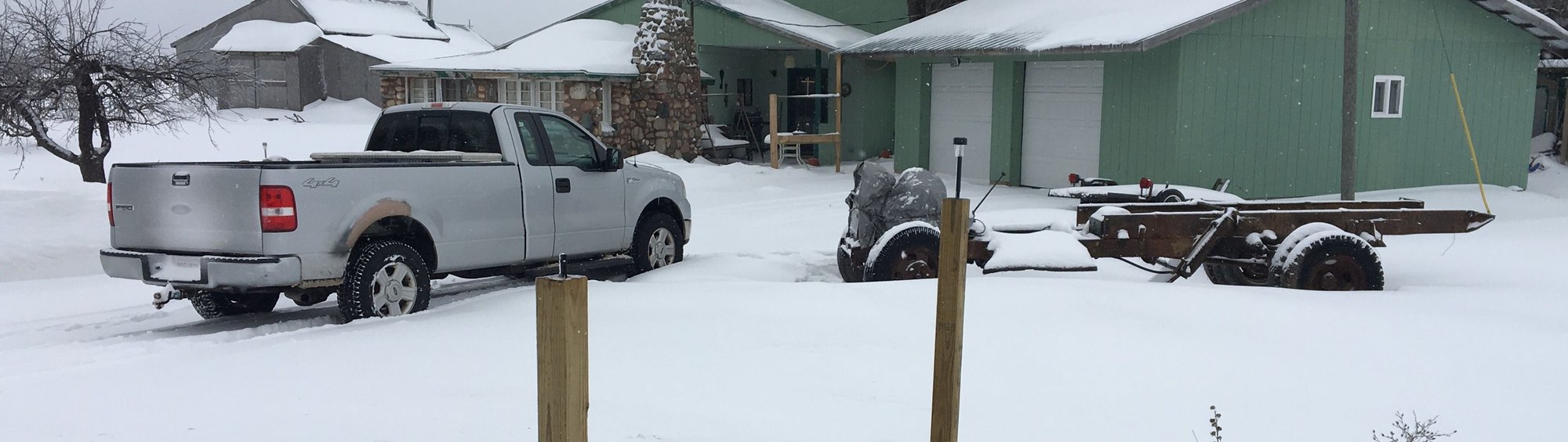

I don't know where it's a 2 ton or a 3 ton, it does have a two speed rear end. As for the motor it does turn over by hand (with a prybar) but he warned that the valves may be stuck open. I won't know until I pull the heads. As for the 2 ton vs 3 ton, how would you tell the difference? Also I am only able to work on the truck for a weekend at a time and very few weekends back to back, will this be a problem in unsticking the valves? Also below is what the truck looked like before the previous owner got his hands on it and the second is as it sat last time I was able to get up north. I have a 1937 cab that is going on the truck and am getting the Chevy wrecker to put parts on the bed.

Rickster makes a good point. AND,,, That is an awesome wrecker body. I sold my '37 1 1/2 ton about 2 1/2 years ago, just coming out of that recession. I always have a lot of ford trucks, but 2007-2015 cleared the lot pretty well. Can't wait to see the finished product. Did I tell you how cool the wrecker body is???
