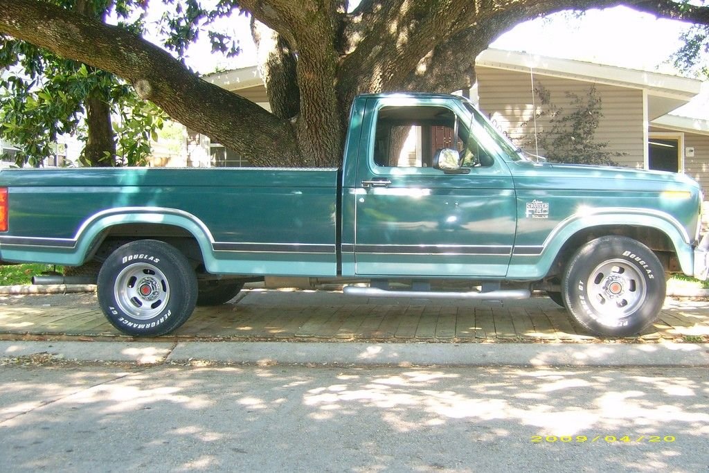

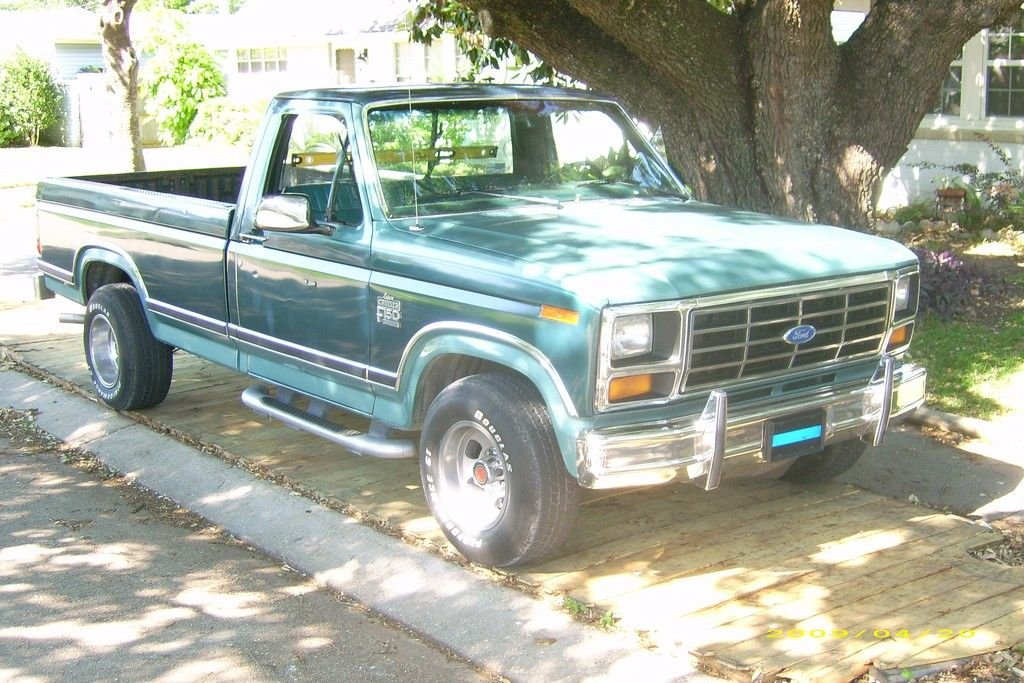

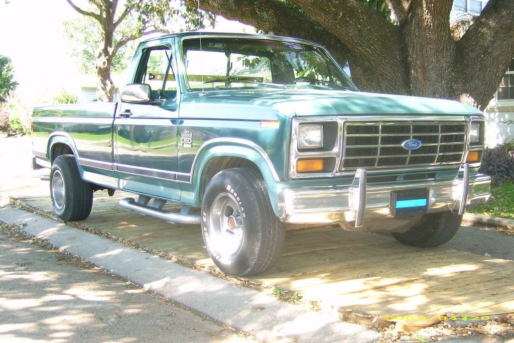

Gary, these were off of a 97 to 03 f150.
These are grom the f150 94 model era.

Kyle - I like the 97 to 03 version as Big Blue is a burly guy rather than a sporty guy. Do you know what brand those are? They look securely mounted - are they?

Gary, they mounted to the seam that protrudes down on the cab. The same way they mounted on the newer trucks. They were very sturdy. You could have them go past the cab if you got a set from a supercab, but may need to make some attachment point under the bed.
They were factory from ford.

Kyle - Are there holes in the seam? I don't remember seeing any.

I drilled holes and used slip on blind nuts like the newer trucks had.
