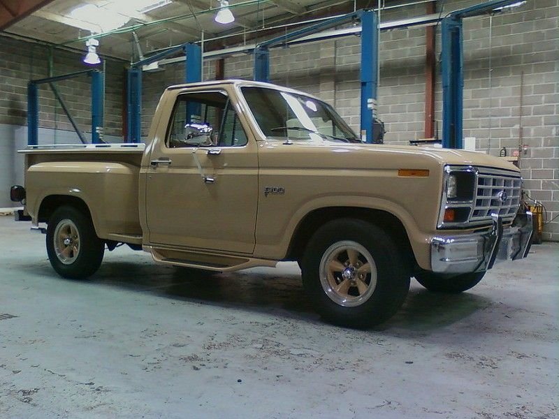

I don't think it needs to be a Flare Side. Here's a pic of my '95 F-150 SuperCab. Obviouslt the SuperCab steps wouldn't fit a regular cab. But I think steps off any regular cab would work, regardless of bed.
But yes, they're still likely to be rare, at least with non-rusted support bars.

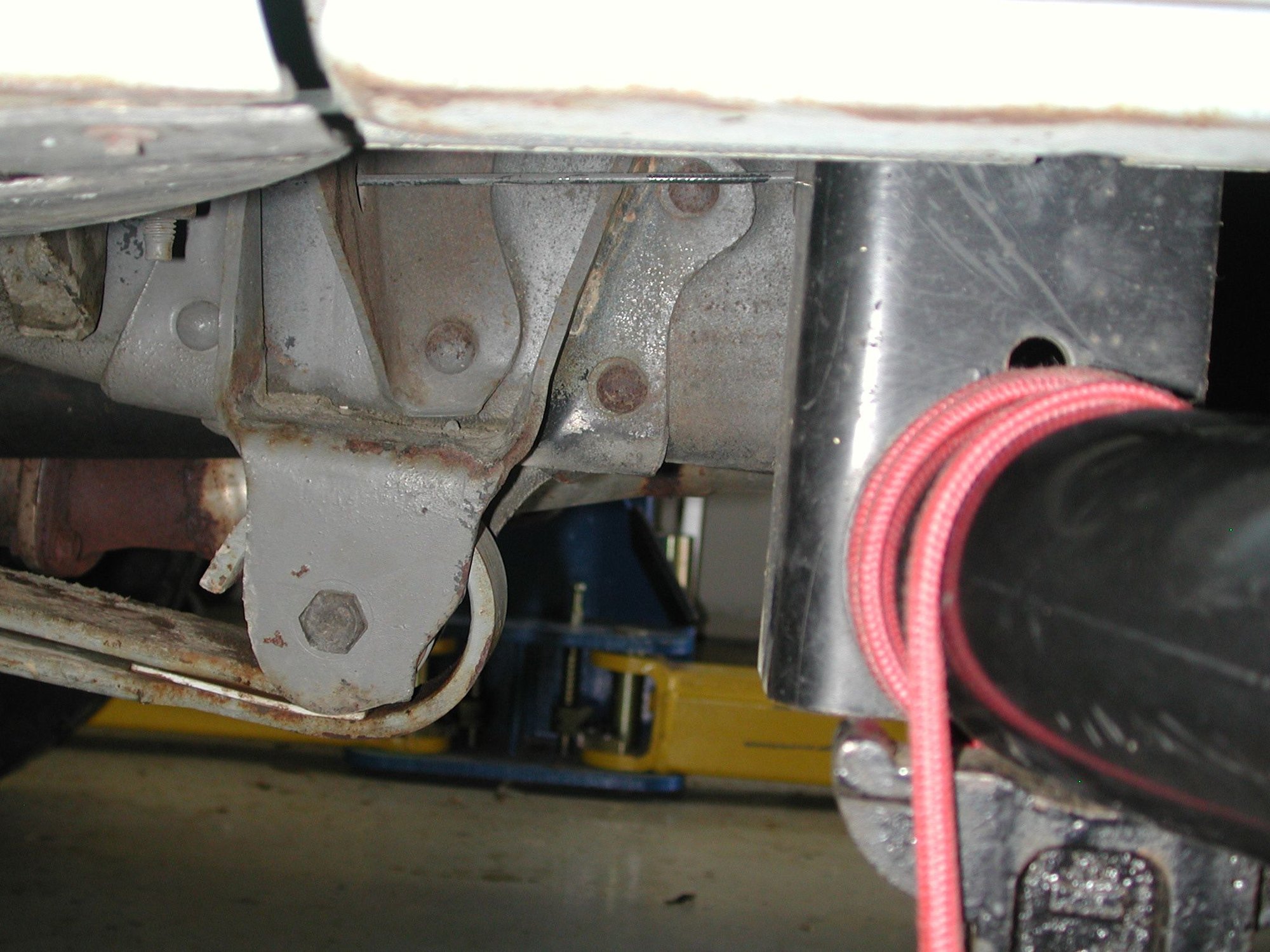

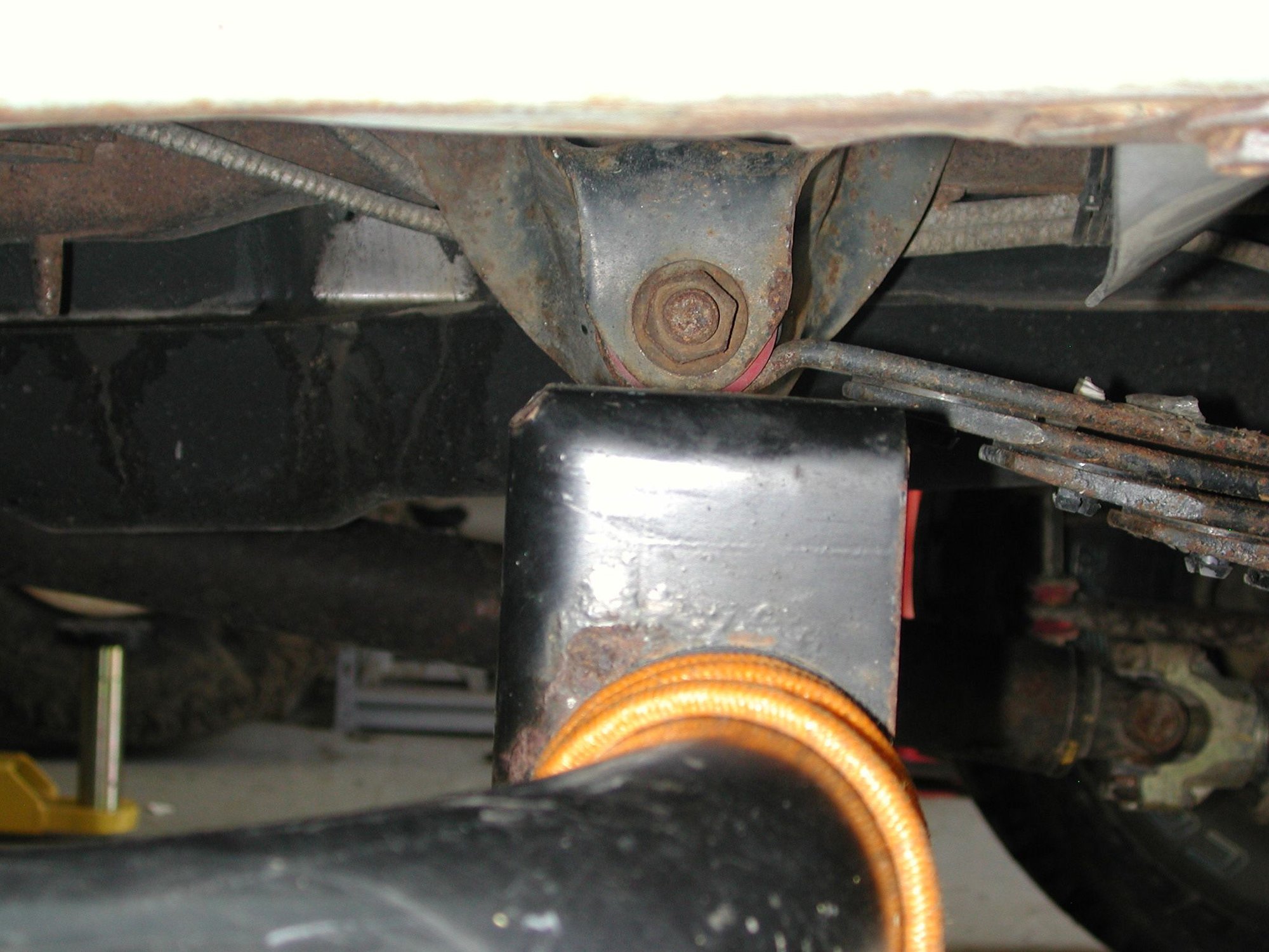

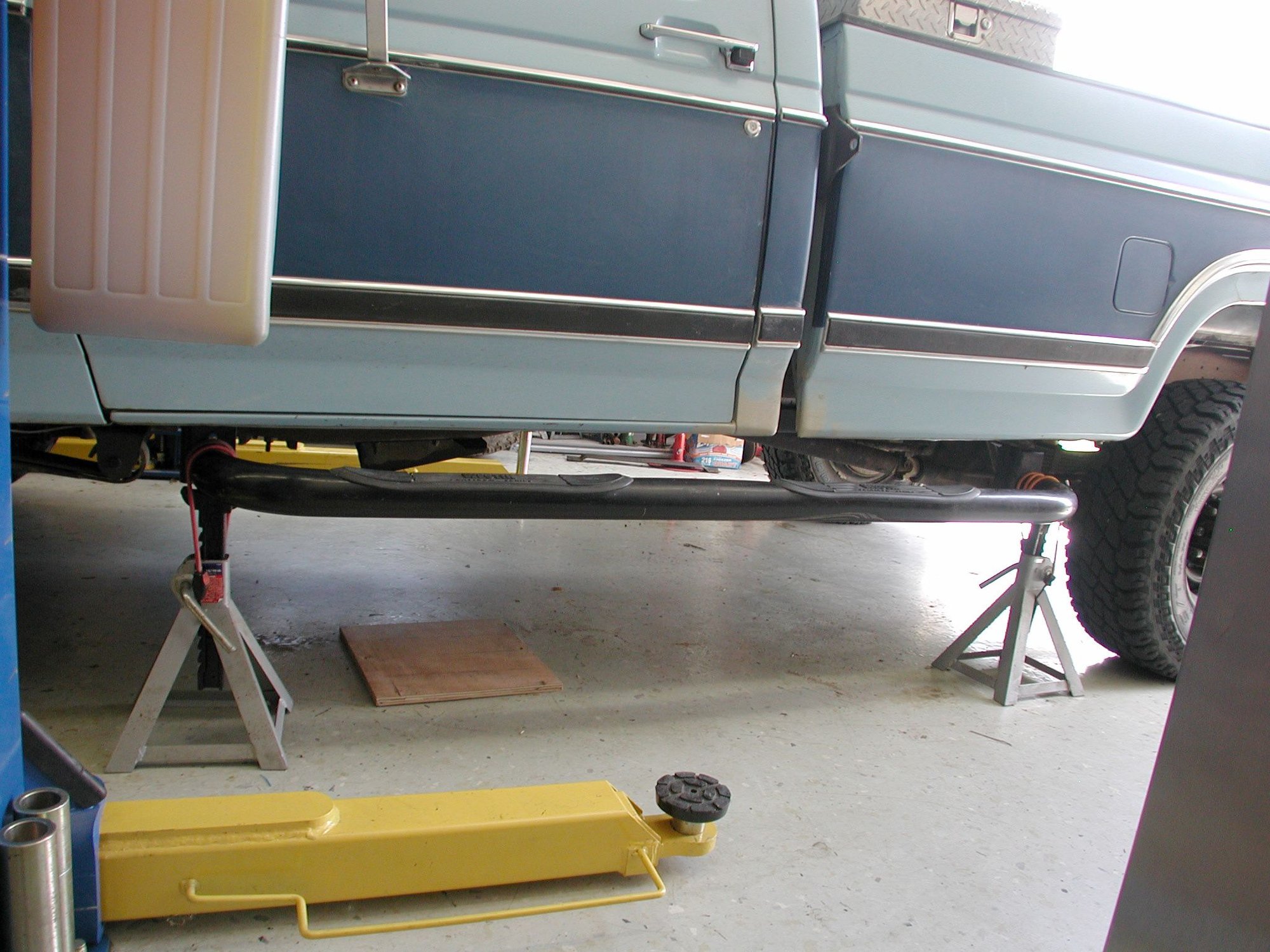

Ok guys, I bought some used Westin Platinum nerf bars today. The brackets aren't the correct ones, but then there aren't "correct ones" for an '85 truck since Westin doesn't make them for our trucks. So, I'll be making brackets, but have some questions for you:
  1. Vertical Gap: How far are yours below the truck? How much vertical gap is there? And how much is needed to get toes in?
  2. Horizontal Gap: How far are yours out from the truck? Probably the best way to measure would be from the center of the bar to the truck.
  3. Level: Do yours sit level, or do they have the same angle as the truck? In Big Blue's case the rear of the bar will be 3" higher than the front if it is to follow the line of the truck.
Here's a shot of the bar somewhat in place, although it is basically level and the rear of it is 3" further below the truck than the front.
This shows where the front bracket might go - bolted to the rear bracket for the front spring, although that will mean I'll have to take the rivets out and replace them with bolts.
And this shows where the rear mount might attach - to the front pivot bolt of the rear spring, but with a arm going up to the frame.

I don't have numbers for the gaps, but to my eye the gap you have at the front looks about right. MAYBE go a little bigger if it seems like you won't be able to fit your feet in. And I'd DEFINITELY keep the bar parallel to the body. I don't think that angle would make it hard to use at all, and I think if it's not parallel to the body it will look wrong.
On the horizontal gap I'd try to have the bars stick out as little as possible while still being useable. As a guess maybe the inside edge of the bar about flush with the outside edge of the door opening, but that's a pretty wild guess.
