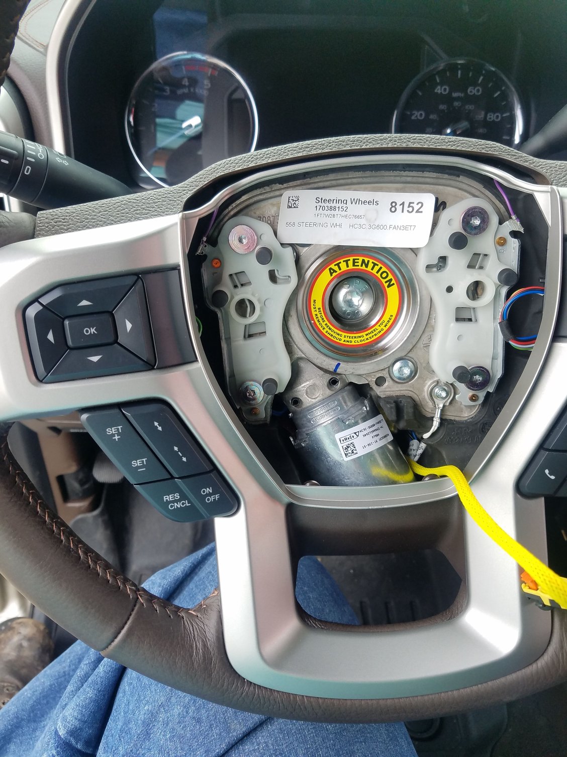

Well I finally had time to work on my truck and program it.
We successfully added adaptive cruise to my truck tonight. Everything works as it should the only thing is ids will be the only way to complete this task since you have to re-program the pcm to accept adding adaptive cruise. FORScan doesn't have the ability to write pcm as built data and the same for ipc as built data. Until forscan is able to do both those items it won't be a easy add on. It will be possible but not with out ids for more then just calibration.

I replaced the switches as well in the steering wheel it's the only way you can control the screen properly.
And yes you can change the the ipc now with forscan and allow it to view adaptive cruise on your dash. But like I said the program the pcm is what is stopping this from being a easy add on task. Because before we shot the data from the other vin on my pcm because I was getting a communication code every time the truck had to apply the brakes.

Ok, so on my truck I just replaced my steering wheel controls not the steering wheel.
And as the dash lines are you talking about the heads up display led? Really won't work with out everything else programmed.
And yes as of now you will not be able to add it with just forscan even tho you can install everything program pic. You still will get a pcm communication code and the only way to program that is with ids you have to shoot data from a vin with adaptive cruise. And most dealers will not tackle this task.
And either way if you did install everything you would still need ids to calibrate the front sensor.

Thanks. I mean the dashed line with arrows on the steering wheel for the following distance. I didn't realize you could replace just the buttons.
Did you add the collision warning red LED strip below the windshield? Does it work?
Yes see the above photos are from my install.
Everything works as it would from factory
