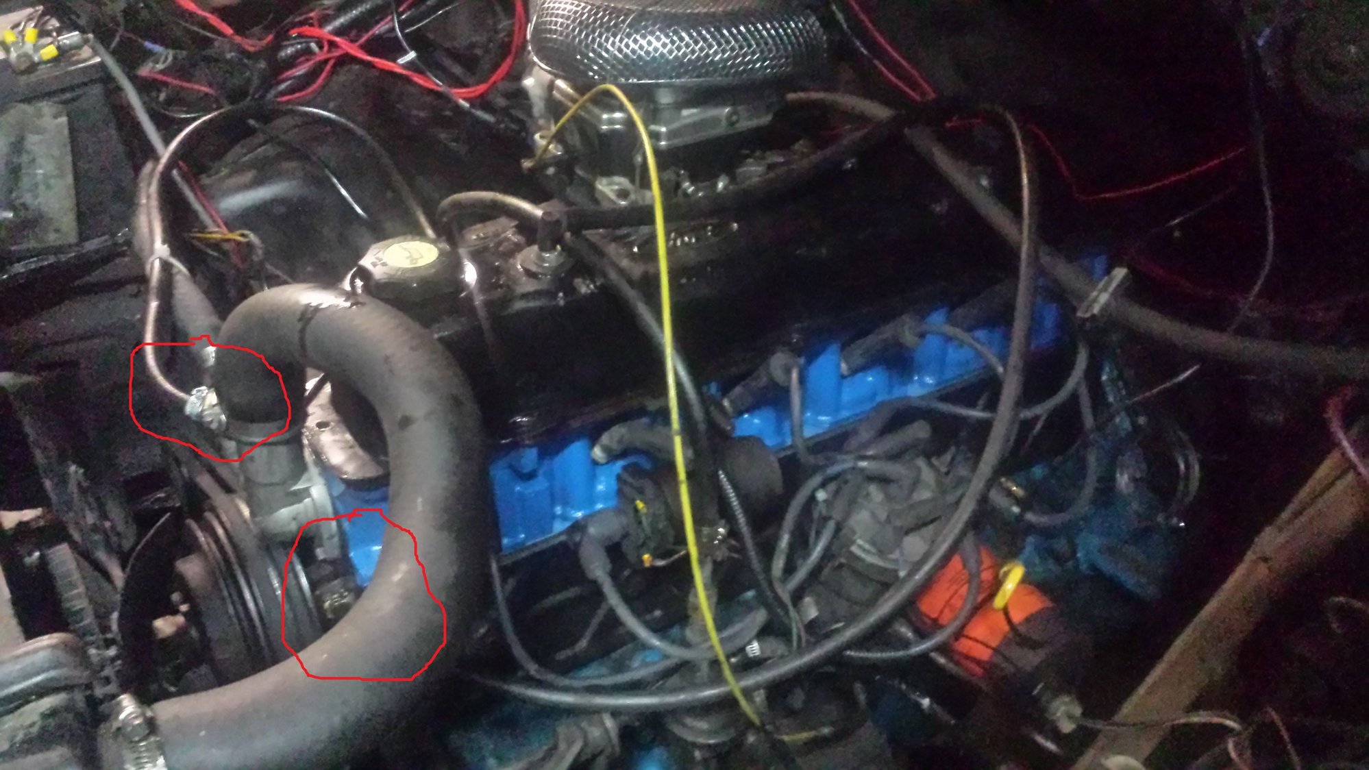

If he wants to use his heater hose, he could probably cut the hose, add "T" fitting of some sort, and run the return to the thermostat housing I suppose.
How my clifford is hooked up, one end into the thermostat housing and the other into the pump. I needed to buy the barbed fitting for it, I believe they were 3/8 NPT. I think it's much easier than messing with the heater hose. I circled the connections on mine.
