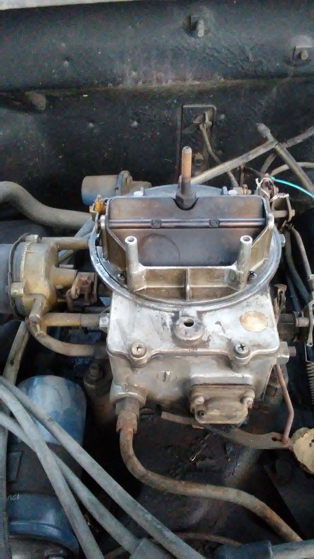

Hello, all. I've bought a 1970 F100 with a 302 and am trying to find out what carb I have on it, as it needs rebuilt. A small sticker on it said reman holley, but the numbers on it were smudged out. I cleaned up the outside with some gasoline since holley should have it stamped on, but to no avail. I was hoping someone on here would have an idea.

It is a typical Ford/Autolite/Motorcraft 2100 2 barrel carb. For a stock size with a 302, the airhorn should have a number stamped on it of 1.08. This is the venturi size. You can google for the cubic-feet-per-minute rating. That was the size of my 72 F-100 302.

2100 series Auto-Lite/Motorcraft 2V carb kit is the same 1962/74, available from Ford & auto parts stores.
D4AZ-9A586-A (replaced C2AZ-9A586-B) .. 2100 series 2V Carburetor Kit (Motorcraft CT-499-D).
1962/74 Passenger Cars/Trucks; 1966/74 Bronco; 1969/74 Econoline.
Holleys have a stamp on the air horn.
On an Autolite 2100/4100, look on the driver side of the main body and there is a cast "clock face" with numbers in the middle. The numbers can be 1.08, 1.12, 1.18, 1.21, 1.23, etc.
Per Rich above, it is likely a 1.08 but who knows after 40+ years what carb CFM is actually installed.
Look up the numbers on the web for a CFM equivalent.
