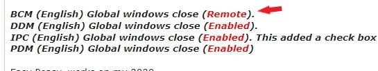

Old Feb 20, 2022 | 01:09 PM
WLR's Avatar
WLR
Joined: Feb 2022
Posts: 27
From: Western NC
Got it! I had missed one place in BCM. Global close now works!
