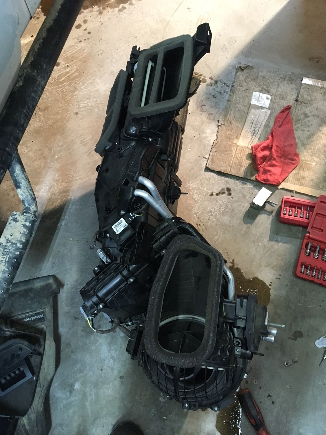

Old Mar 27, 2017 | 05:37 AM
BBsound's Avatar
BBsound
Joined: Jul 2013
Posts: 96
well.................
Old Mar 27, 2017 | 06:51 AM
Slowpoke Slim's Avatar
Slowpoke Slim
Joined: Nov 2012
Posts: 1,169
Likes: 29
From: Bismarck, ND
Oh man, ouch. Going to pat mine on the dashboard on the way to work this morning...."good truck, good truck..."
Did you find it with the leak dye?
Old Mar 27, 2017 | 09:51 AM
m-chan68's Avatar
m-chan68
Joined: Mar 2010
Posts: 5,505
Likes: 257
From: Woodbridge, Ontario, CA
Good job. Are you doing the work yourself?
