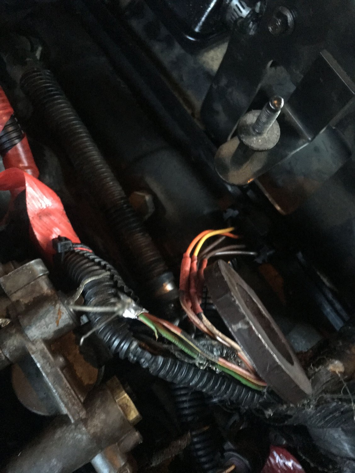

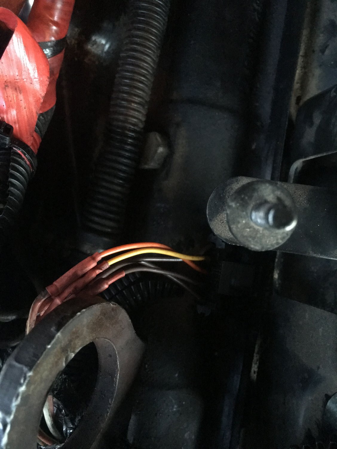

So so here's what I got. Went and messed a bit today. All valve cover plugs appear to be fine. He said 2 and 4 but everyone calls it different. Figured out it's the 1st and 2nd cylinder on the driver side. Does anything stick out about the wires? I did not buy oem valve covers so colors don't match. This is what I have so far. Would appear orange is connected to a orange and white stipe and yellow is connected to a white or grayish wire

I'll take a look at mine here in a few. I'm running Dorman valve cover gaskets on mine, so I'll see if the colors match. It's hit or miss with those Dormans, so the issue could be under your valve covers.
Yes, 2 & 4 cylinders are the front two on the driver's side. Looks to be a couple of nicks on the insulation of the wires prior to the wire splices, so check those over carefully. The shielding covers the 3 center wires as those power the injectors with the center wire being the high voltage feed for both 2 and 4 injectors. That could be the common problem if neither injector is firing. The odds are that the problem is with one of those splices or under the valve cover.

It looks to me that butt connectors were used to splice the wires. If so that is no good. The wires need to be soldered together. I learned the hard way on my 97. They worked for a while, then the truck developed a miss that would "fix" itself, then progressed to a miss all the time. After cutting the connectors out, and soldering the wires, all was good.

^^^this butt connectors ain't worth a chit, solder and heat shrink for best results.

And one wire at a time so you don't have to think about what goes where.
