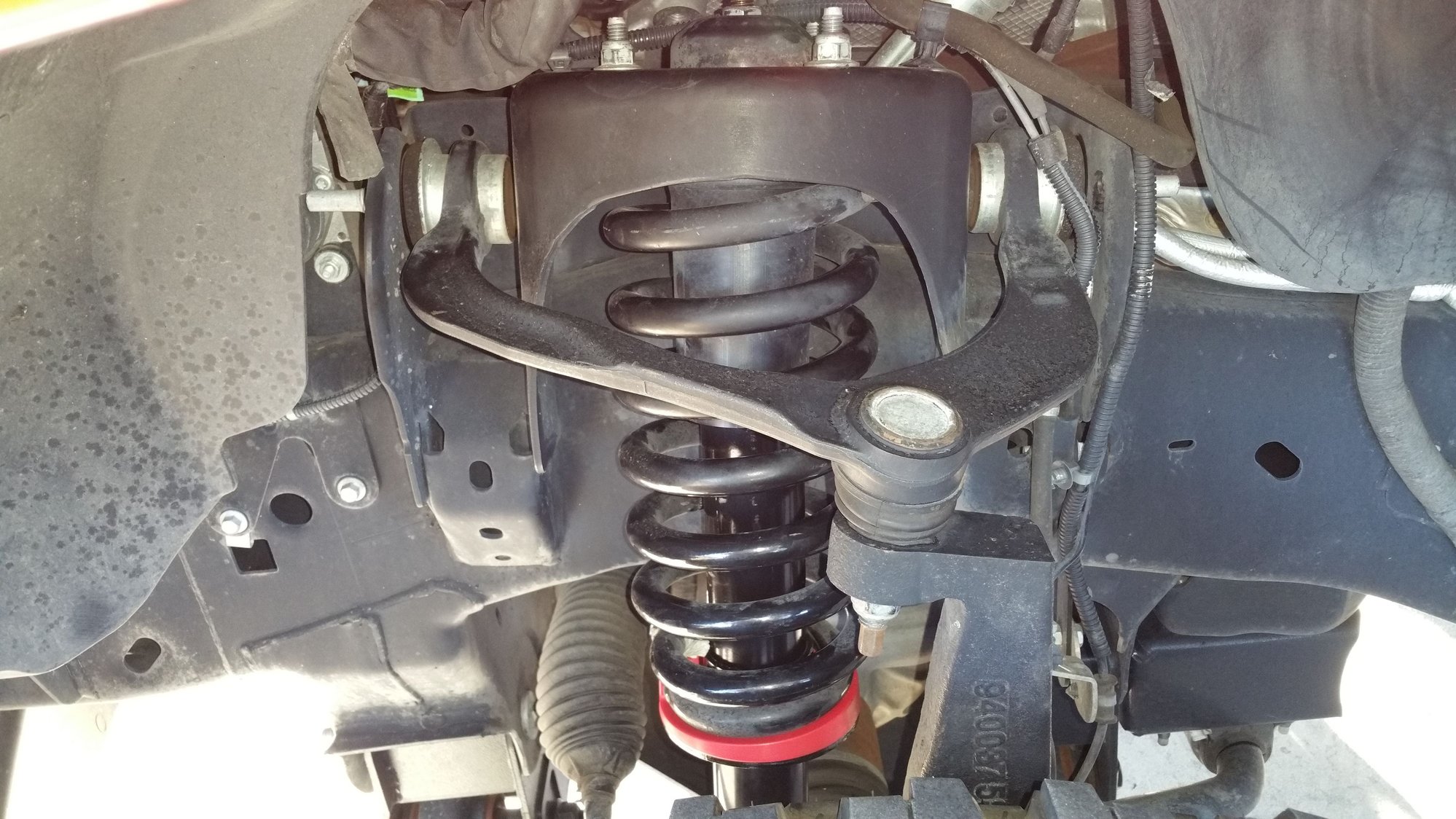

I dont think the bolt configuration is going to cause an issue.
The problem is getting the lower control arm low enough for a longer than stock strut or a spacer on top of it. I realize your lower control arms are already lower do to the lift, but is it enough to get that extra tall strut? Thats the question at hand.
It looks like if you don't want any more lift, you will probably be OK because of the lower arm relocation. But that extra inch may cause some grief.
Sometimes just to get an extra 2" you need to take the spindles.loose from the upper or lower just to get the lower arm down far enough to get the strut In below the spacer.
Not saying you will, not saying you won't. Just something to think about.

Your going to need a really good, and fairly long pry bar and put it under the bottom of the strut and compress that strut so you can get it out of that "Pocket" that the strut sets in.

I think your right a pry bar would be necessary to lift and nudge the strut out towards the tire. Studying the pictures I conclude the space needed for new 6" strut is there once the spacer is deleted ...all this is mute as the spring is my real concern anyway. Ahhhggggh just hate to pay someone to do something I think I could do myself plus now my brakes are starting to squeal, those I know I can handle and would actually like to upgrade rotors and pads from oe which I could do with money saved from self strut install

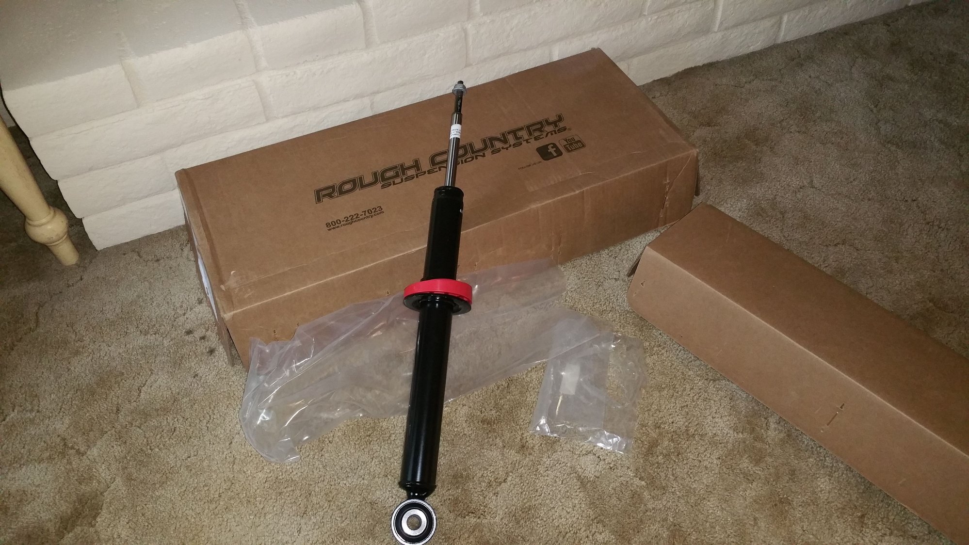

Went ahead and ordered the Rough Country 6" lift strut which will eliminate the current 6" spacer that sits on top of the strut now. Really was on the fence about buying these vs Bilsteins, Bilstein made a similar strut or perhaps they still make em but finding them for purchase is another story all I could find is their adjustable leveling struts. Going to have the shop that installed the lift put them on next Tuesday, I'll report back with the results then.

Well there on and I'd like to say the ride difference is amazing but it's not. There is alot less nose dive on harder braking. I'm thinking of changing out rear shocks as well now. Will be having the tires rotated and balanced this weekend. Rest of suspension is tight ball joints etc... so hopefully this will stop the excessive wear rate on the inner tire.
