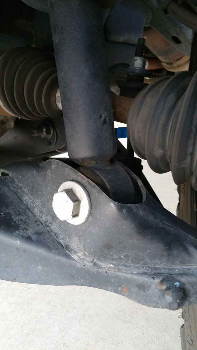

This is mine ...looks same as one in Makulocos video, really only one noticeable difference the lower strut bolt mount area is different.

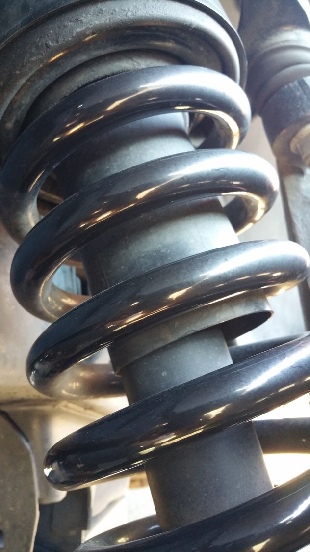

This is the 6" spacer which site atop the strut, still only three nuts to takeoff.
This is mine, notice how the strut sits in a lil cave of sorts unlike the one below ...i dont believe this would be a reason to not disassemble the same way Makuloco did.

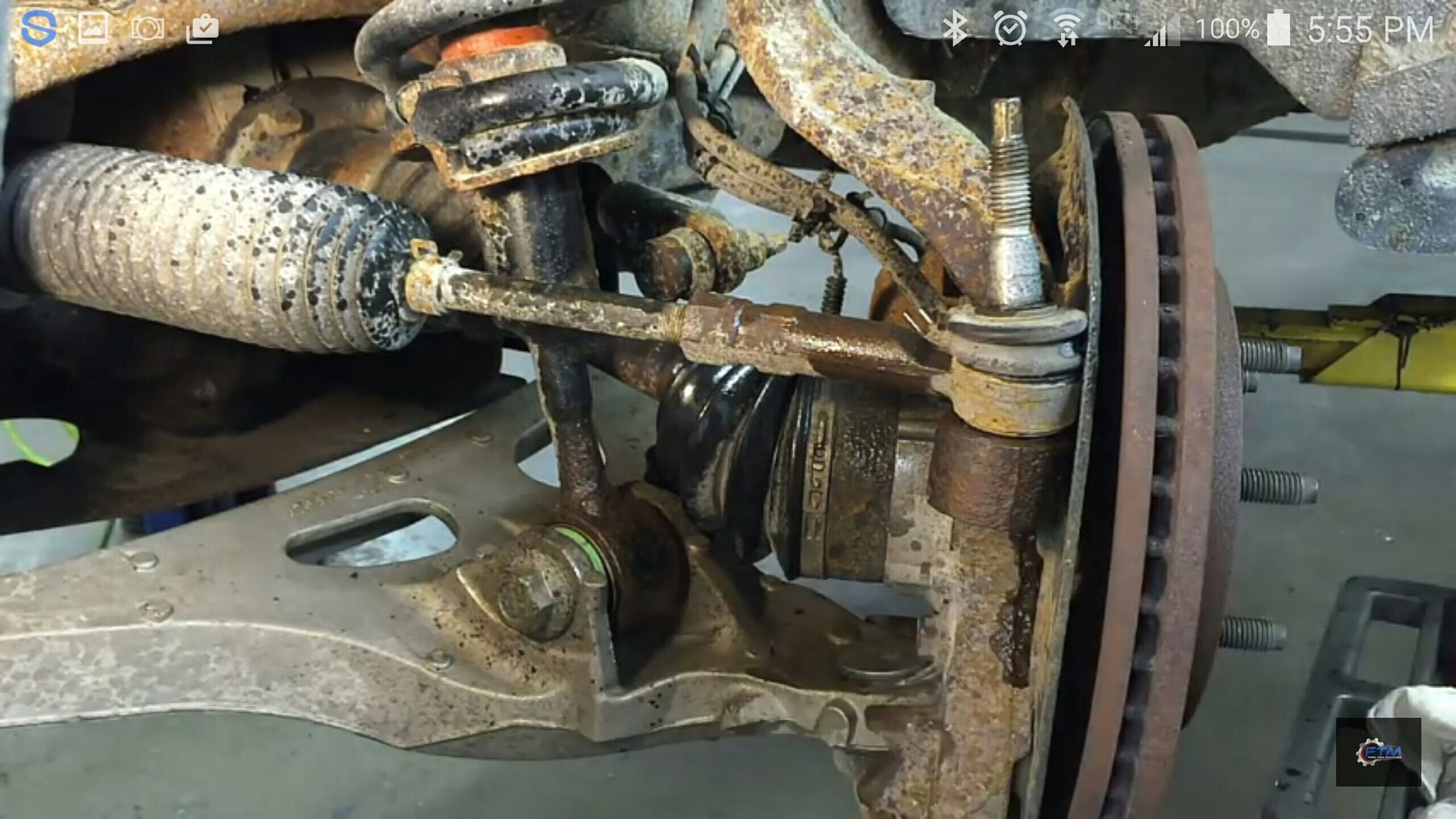

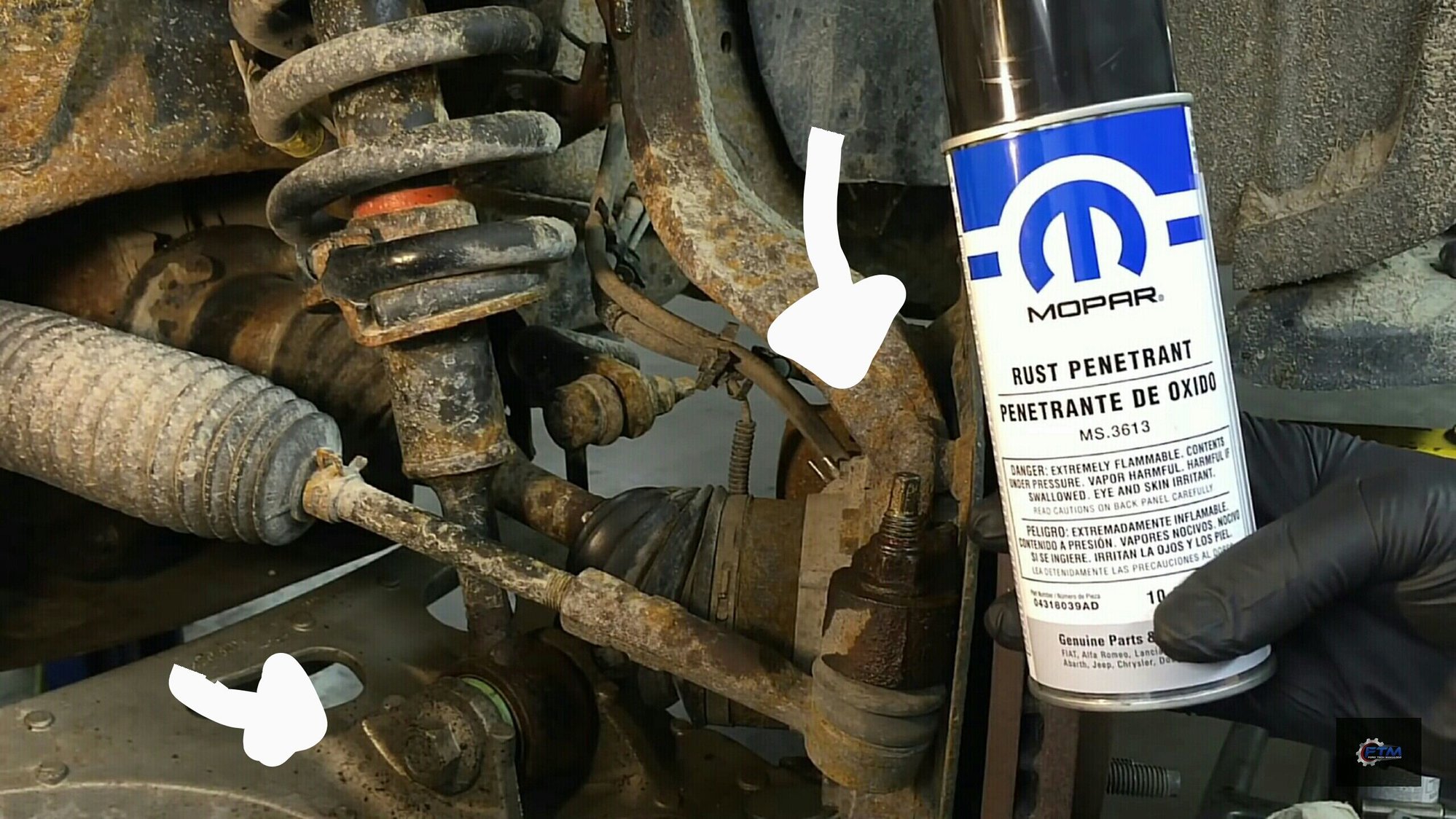

Truck in Makulocos video.
