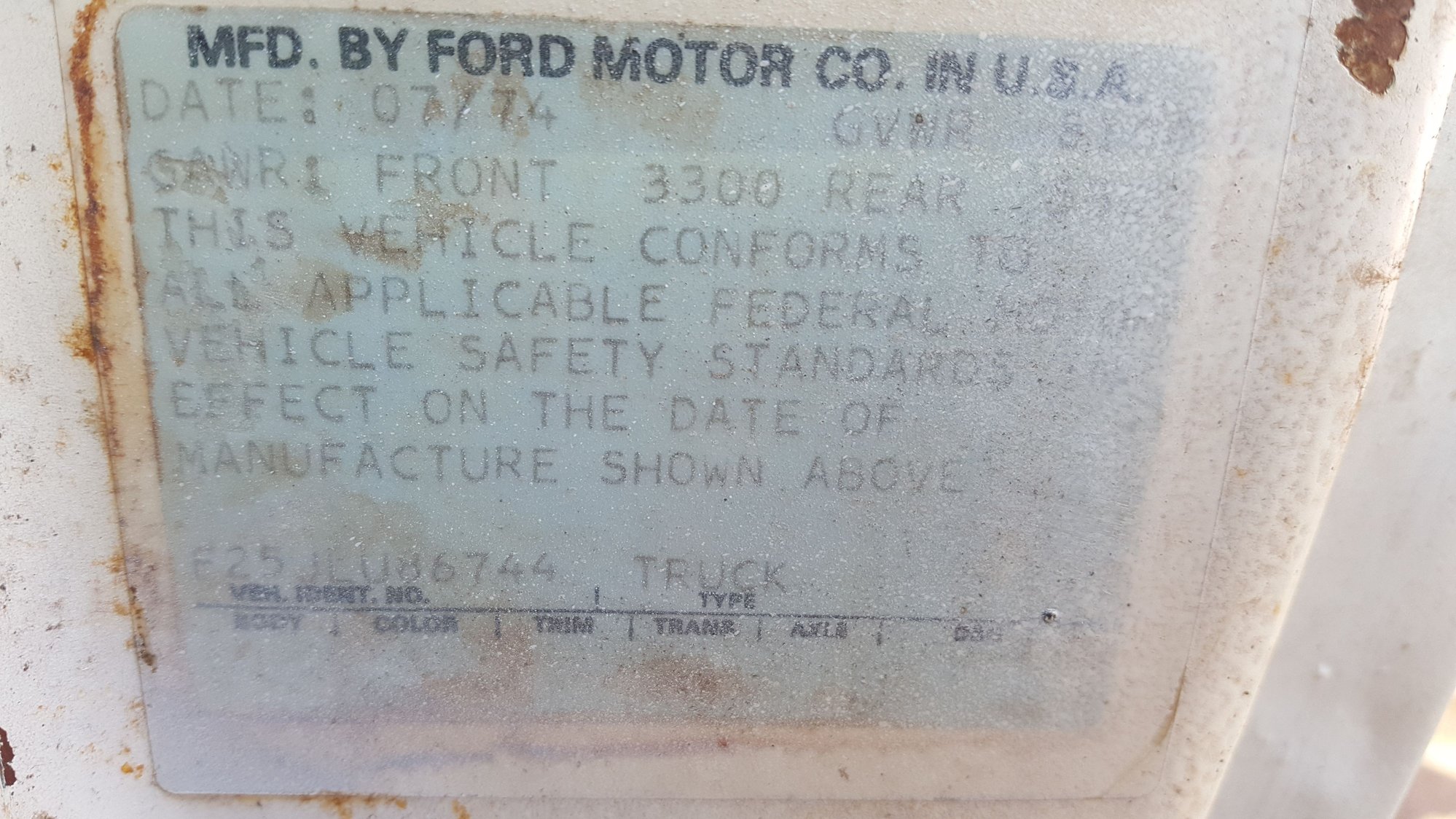

Just in case anyone trying to help me solve this puzzle thinks maybe the door has been replaced, here is the cab sticker.

VIN on Certification Label ^ matches Warranty Number on Warranty Plate.
F25JLU86744

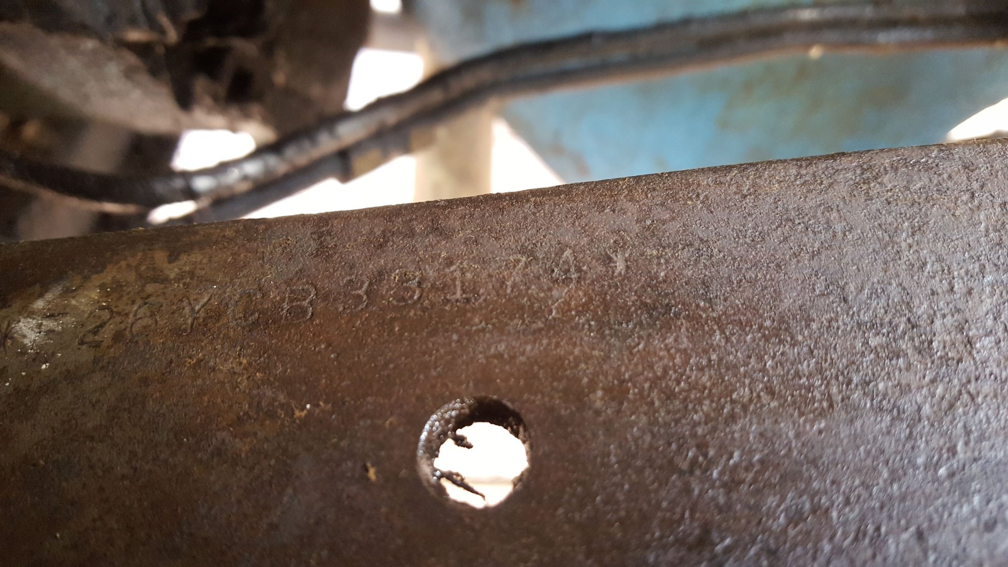

I found the frame serial number.

VIN: F26YCB33174
F26 = F250 4WD Pickup.
Y = 360 2V
C = Oakville Ontario Canada Truck Assembly Plant.
B33174 = 1976.
1976 US/Canadian F100/350 COLOR code NM: N = Coral / M = Wimbledon White.

so the frame and driveline are 76 and the body is 74. The chassis is from Ontario and the body from flint. I wouldn't mind knowing the story of how the two came together. We know the body originally was on a f250 2wd chassis with a 460 and auto transmission. Would be nice to know more about the body that came on the 76 chassis.
