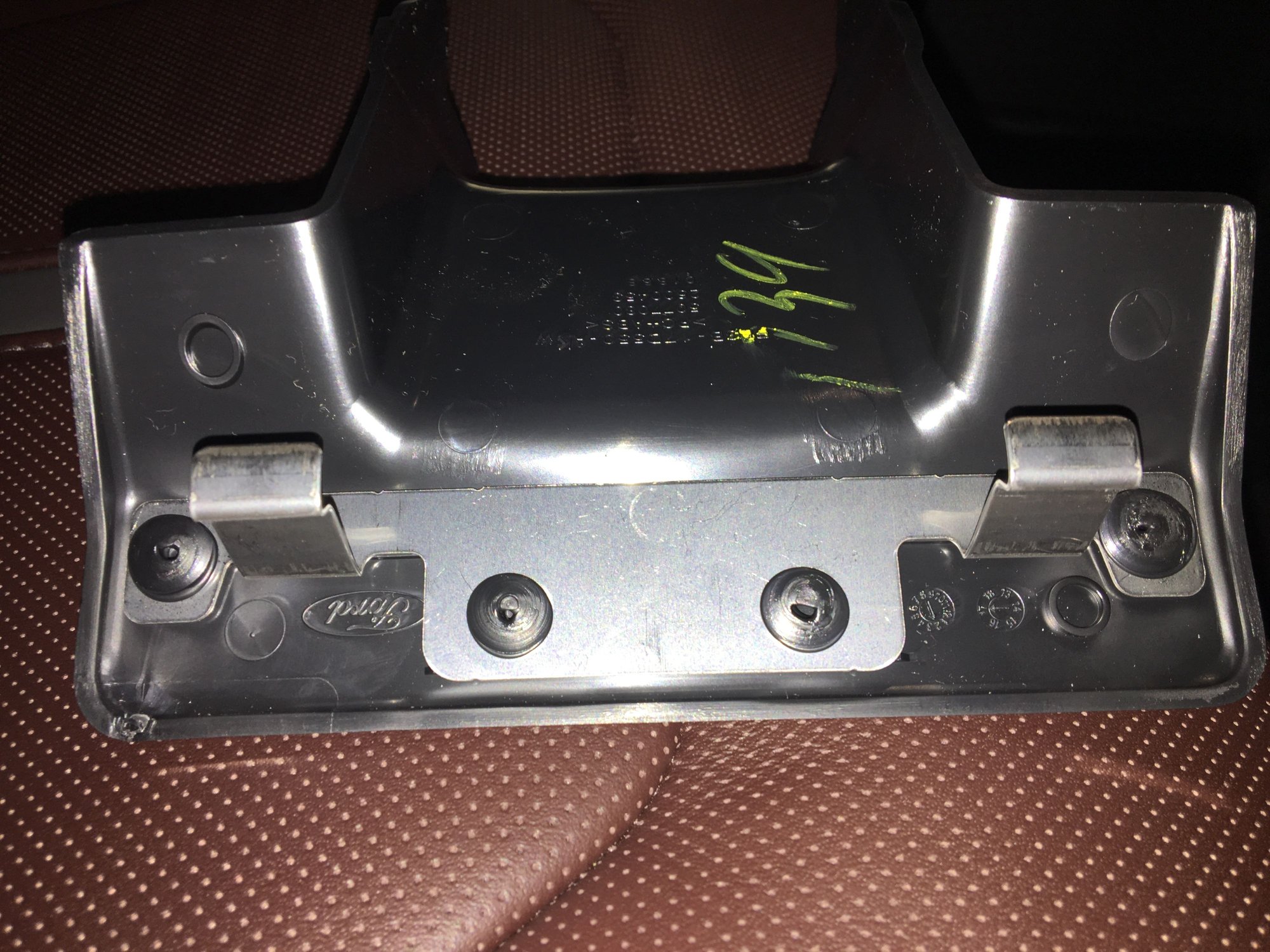

While you have it off get a picture of the cover you removed so we can see where the clips are, please.

Here is the cover turned over. Slide your finger or a tool and press the silver clips away from you while pulling down.

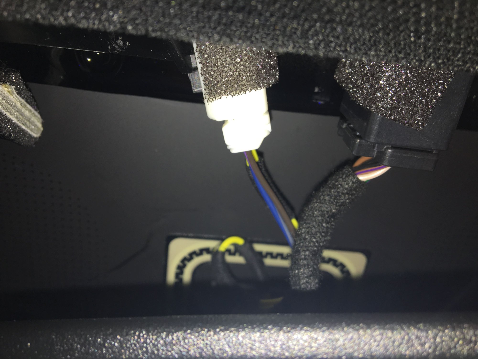

Now the question I have... does anyone know which of these wires are power and ground? (I will start actually tapping later today when my detector, mount and wire come)

Ok, got this done. In short...
1- Follow the directions in the post on the F150 forum that JCW posted.
2- I ended up taking the lower plastic piece off and to my surprise, even though I don't have lane departure, etc. The camera is in there.
3- It's easiest to unclip the white clip and then do the tap. To do so, one long side has the release. Press in the center to pull the plugs apart.
4- The wire-taps are as directed in the F150 forum. The top black wire is ground, skip a yellow with the line, tap the next solid yellow for hot. AND... DON'T make the same stupid mistake I did and test it after tapping and not plugging it back in. DOH! Cost me 20 minutes of troubleshooting thinking the tap didn't make contact. (And I'm an Electrical Engineer!)
