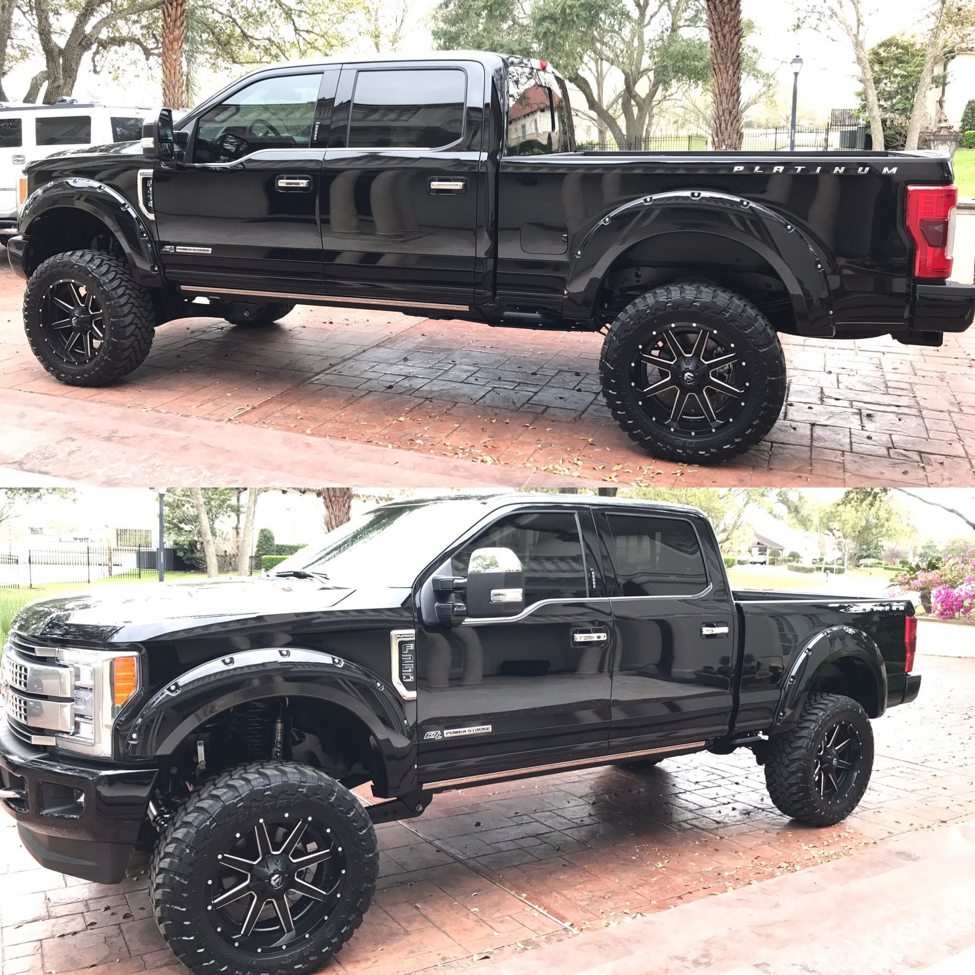

I did a 6" ready lift with bds coils, fox shox all around and stabilizers and it rides perfectly. I personally think it drives better then stock - just got the truck Friday and zero complaints
Looks awesome.
