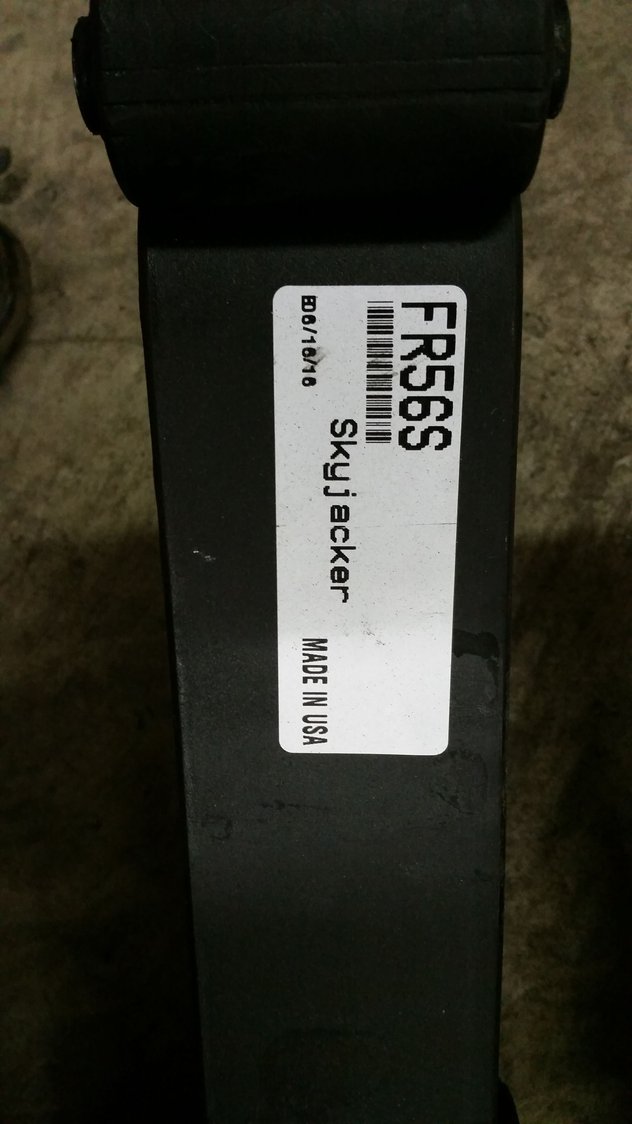

Well I figured I would post an update on here.I did a lot of searching in my area and found 2 spring shops that build spring packs. They both wouldn't touch building the lift springs with a ten foot pole though. They were both capable of building them and the one even built them in the past but said they could no longer make them due to insurance liabilities. Kind of a shame you have to be so paranoid about being sued by people anymore.
​​​​​​​So I called Skyjacker and told them about my Cummins prediciment. They don't make custom spring rate kits but do make add a leaf packs for snow plow trucks, etc. I ended up ordering their lift kit with the add a leafs from 4 Wheel Online for $1300.

The best part: MADE IN THE USA
