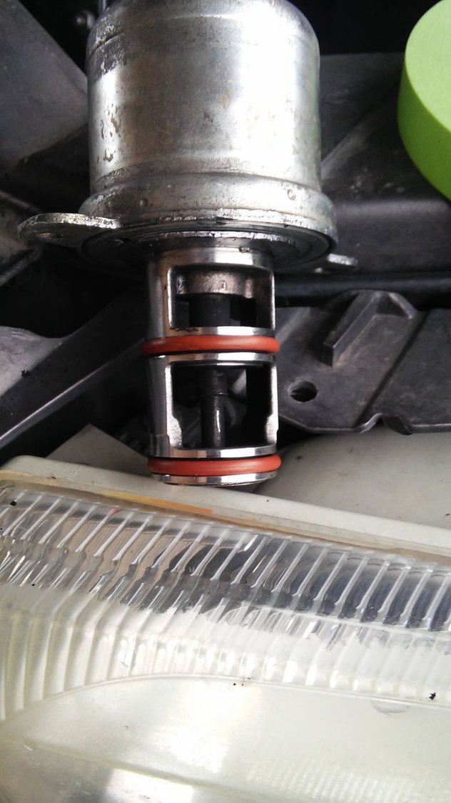

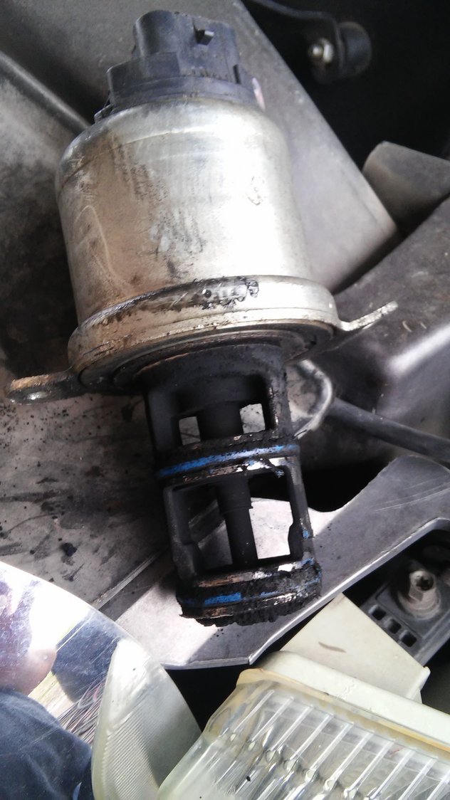

Old Mar 5, 2017 | 02:10 PM
Duck410's Avatar
Duck410
Joined: Feb 2015
Posts: 29
From: Oak Grove LA
Before and after
Before
After

Old Mar 5, 2017 | 05:07 PM
Yama4fitty's Avatar
Yama4fitty
Joined: Apr 2016
Posts: 922
From: SoCal
WOW...you cleaned it so good you made the blue o-rings orange!!
