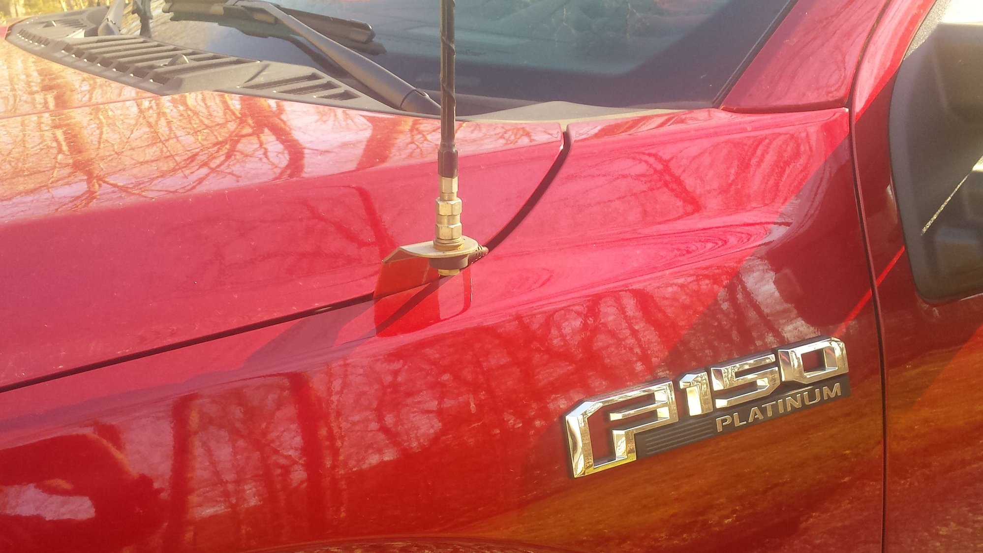

I have used a FireStik CB Radio hood channel mount on my F-450 and then moved the same mount onto my '15 F-150. It is a very easy installation and I ran a ground wire directly to the battery.
CATALOG Main Page (Frame Setup)

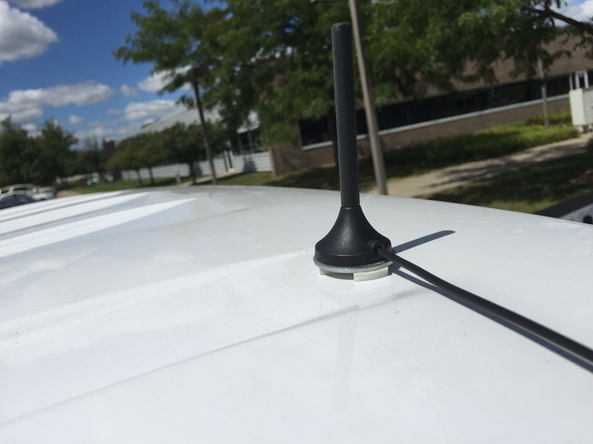

Here is what I did for my cell booster.
I used a washer and doublesided tape to get this done.
Old Mar 6, 2017 | 04:58 PM
norcal_flyfisherman's Avatar
norcal_flyfisherman
Joined: Jun 2016
Posts: 23
Does the double sided tape last long?
Old Mar 9, 2017 | 10:19 AM
CA55F100's Avatar
CA55F100
Joined: Mar 2005
Posts: 335
From: Ames, Iowa
We have a pile of trucks set up this way and have been for about a year. No issues. Many car washes as well.
We also do this with plastic cabs on tractors, combines and sprayers. All have no problems, and generally, the magnet is more weak than the tape.
