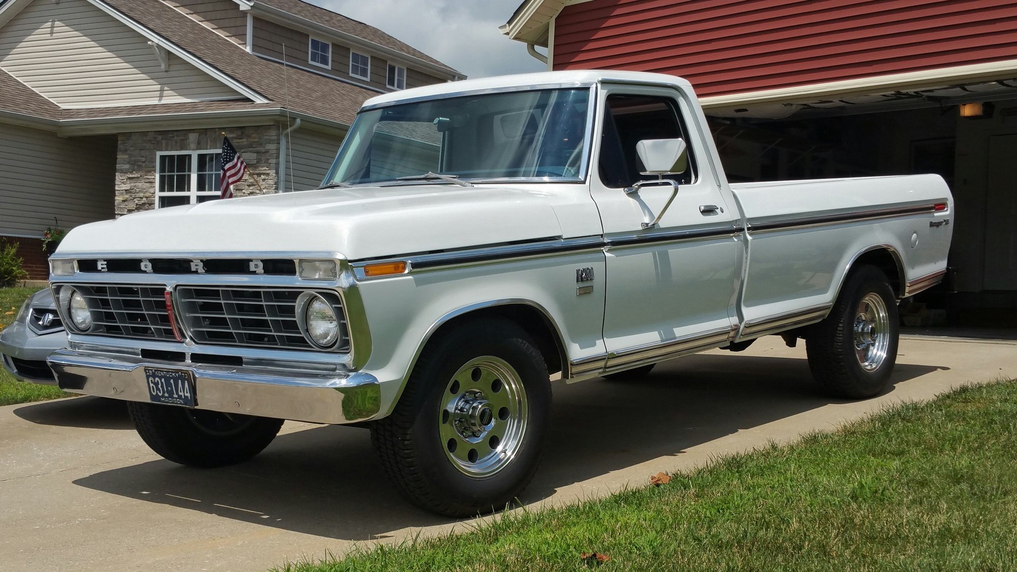

I have some monroe shocks on my truck now but I am disappointed with the way it handles the corners. Way to much roll. What do you guys think is the best shocks for better handling?

Good looking truck, but you need to get that hood adjusted down-you could throw a cat through there!
