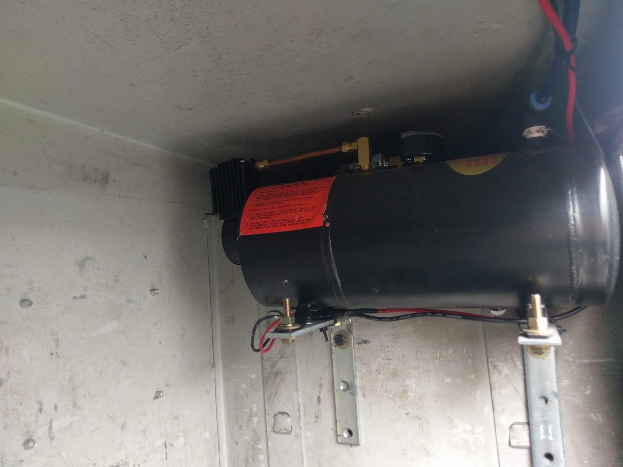

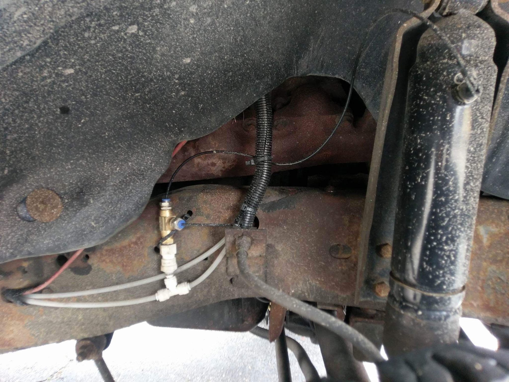

I run air lift rears and Monroe fronts. The compressor kits you buy are complete junk. They don't regulate pressure at all. You hold a button and watch a gauge to refill them. All air bags leak at some point in my experience. I bought a cheap ebay air horn compressor, ran the line to my cab into an air regulator, where I can adjust the pressure as I drive and see fit. Compressor comes on at 90 of at 120 automatically and my regulator maintains my set pressure. You need check valves for the rear and from front to rear so you don't get bouncing when you connect multiple airbags.

I like the idea of building on board air with a regulator. The kits either look really cheap or they are grossly overpriced. Just for good measure I believe I will do this before I level it up
