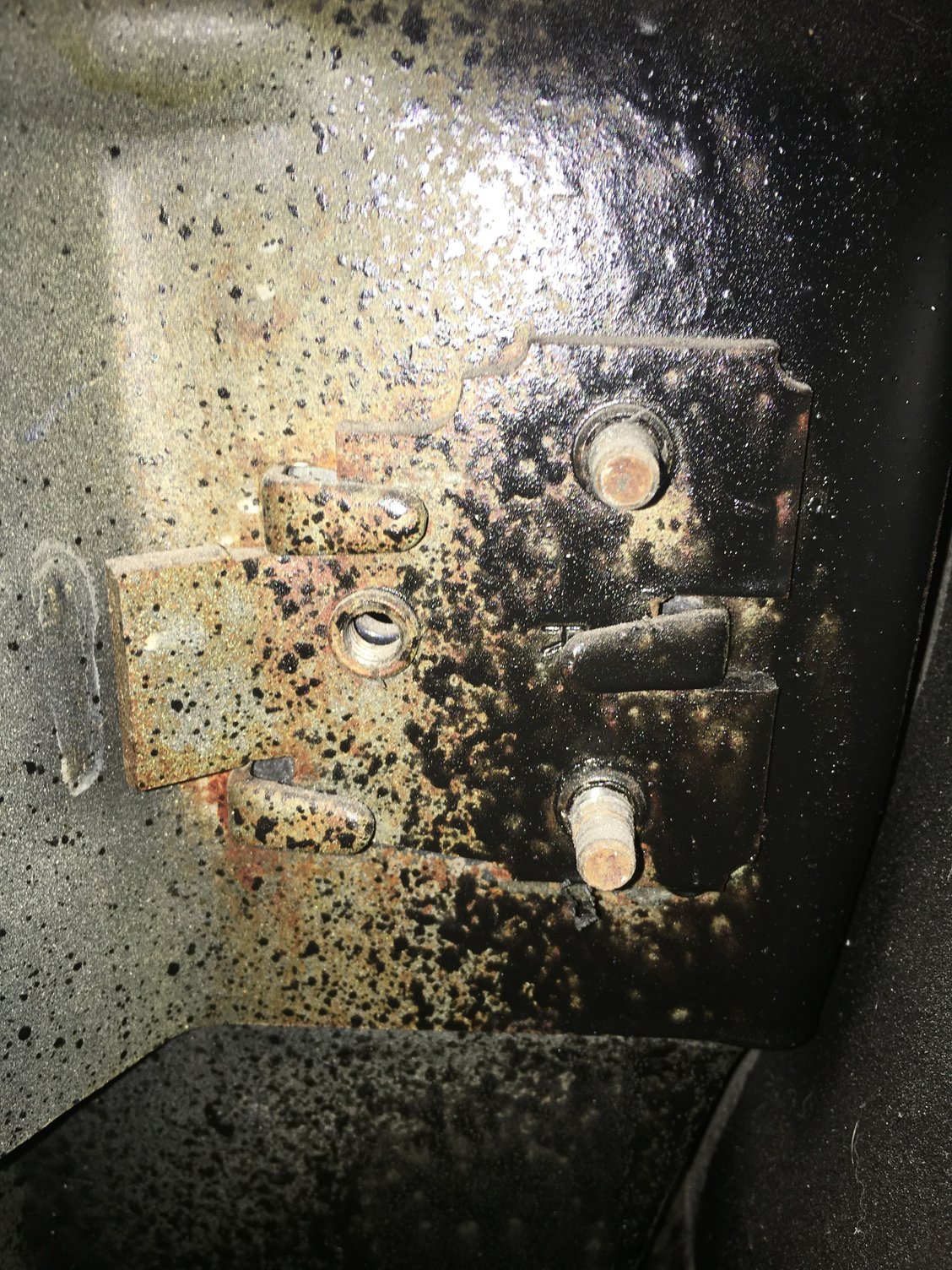

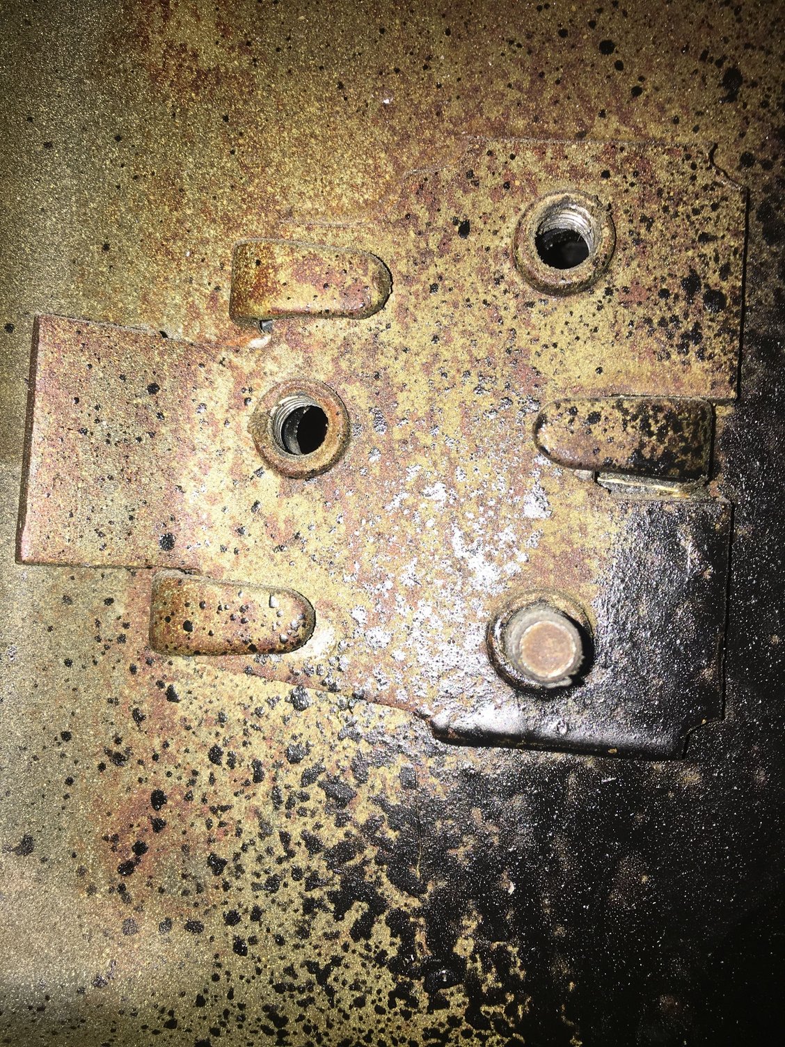

Take off door panel. Look inside. Bend back tabs. Remove plate. Weld up and re-drill hole. Tap for 5/16-18. Insert and hammer back tabs.
Bottom plate:
Top plate:
Can't see a reason to cut the door open when there is plenty of room.
