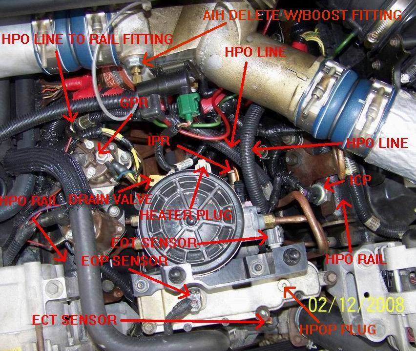

Originally Posted by like a bus
the kit didn't come with the T for the map so I went to the manifold. The black y pipe that goes to both head and the turbo. Should work right? I pulled the line and started truck and not a lot of air shoots out but it does blow a little and I figure we're only taking about 10-15 ftp.
I can't picture this. Can you post a pic of how it's plumbed into the manifold? Did you delete the AIH?

don't know what the AIH is and it probably wouldn't show up in pic. I took off the Y pipe going from each head to the turbo. I wanted the line to travel naturally so I tapped the back so line would run to firewall w/o any more bends then necessary. I got to have clean running wire's, hose's whatever. I put it close to the top right where both ends of the Y meet on a somewhat flat spot. I've seen it done in the same place only on the front and the guys loop the line around. I'm not afraid to put in a little extra work to make it right. Its like it aint even there

AIH = Air Intake Heater
You can see it in the spider in the picture below.

yeah mines different I've got a 96 7.3 there's a black Y pipe in front of the turbo

Joined: Mar 2013
Posts: 22
it basically goes in where the gpa in the pic is and same on other side
