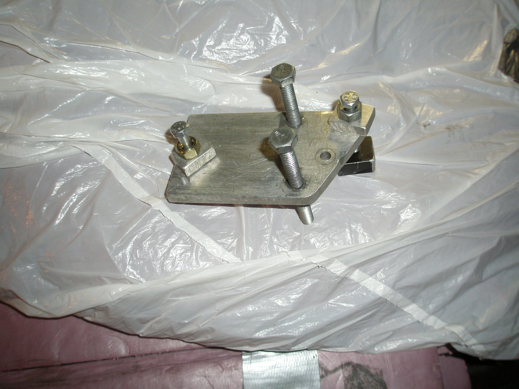

To: TooManyToys there really wasn't much to look at but I thought you might like to see my homemade valve spring compressor

Sorry to hear BG. And this one has studs!
I've got a factory rebuild as well at 70k and have to get under the valve covers to check mine as I believe I hear a valve train issue too. At least yours was cheap.
I like the inventive tool.
