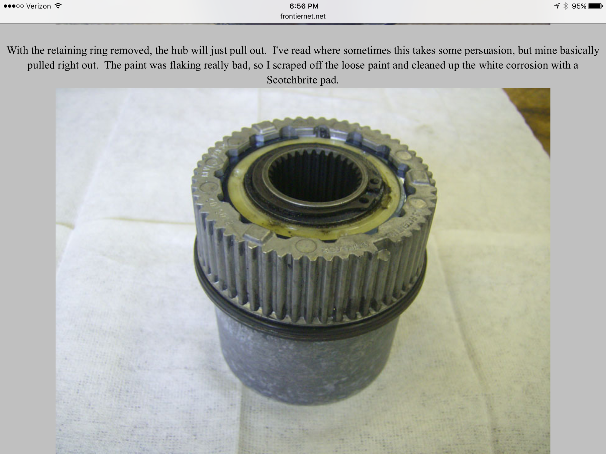

Ok I have replaced this one the yellow o ring that fits on the back of the hub. Still does not pull a good vacuum on this side.
Is the other seal the black o ring on this part
Or is there yet another seal on the axle that needs to be replaced
Regards Mark

That is the seal that I don't know the number on.

You can get that hub seal at Advance Auto, Dorman made.
The yellow ones the wheel bearing seal.
The big axle seal looks like a huge donut.

There are three seals Mark. The Axle seal, the wheel bearing seal and the hub seal. Any one of them can cause it.
