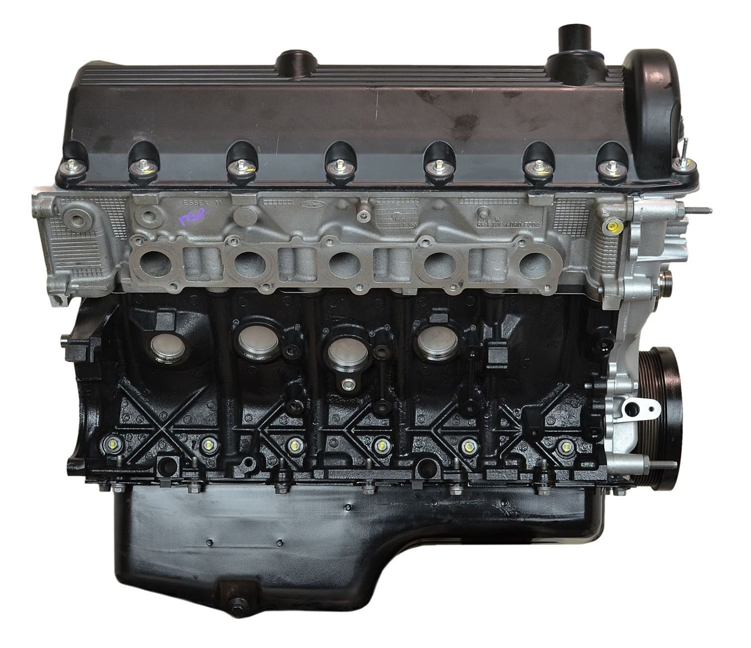

The oil pan & sump is different, in the van the deep sump part of the pan is shallower and longer front to back so the oil pick up tube has to be shorter. The oil dipstick tube is much longer on the van. If the truck engine is cratered, make sure to clean out the pan and tube REALLY good if you plan to reuse them. Same with the oil filter adapter, the truck and van parts fit different and are not interchangeable.
^ Truck V10
Notice the oil pan and oil filler adapter.
^ Van V10
Notice the Oil pan is longer fore and aft and not as deep as the truck pan which also requires a different pick up tube to match the pan.
^ Truck V10
^ Van V10
Man when I see a picture of a clean new engine it's just the coolest thing. Especially something powerful like a Ford V10. Or once in a while you see a cutaway picture of a Lamborghini or something.
