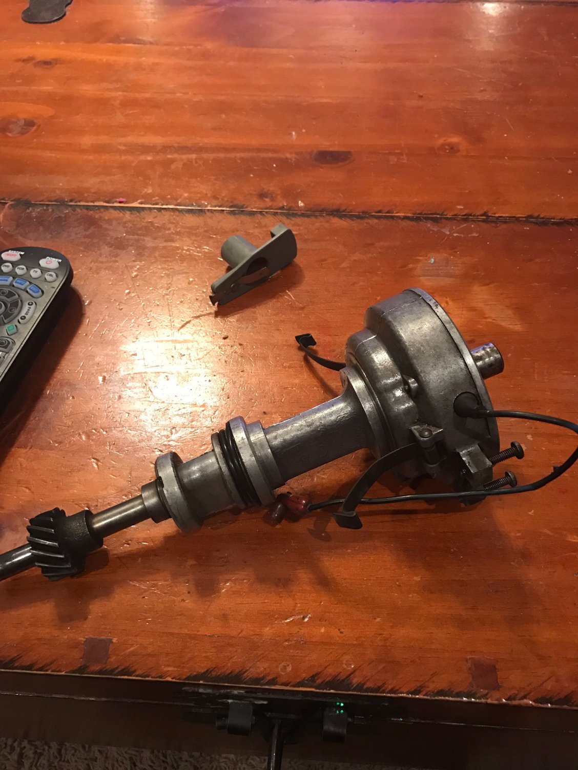

i am building a 56 f100 and I just got my freshly rebuilt 1968 302 back. It is carbureted and c4 trans.. just for info. I have the stock distributor marked motor craft d30f 12/27 HB 2m20.
problem is I have spent a lot on this engine and have a ton more on the rest of the truck to buy, so my plan was to keep the original distributor and get new points, capacitor, cap, wires and hopefully spend no more than $100.

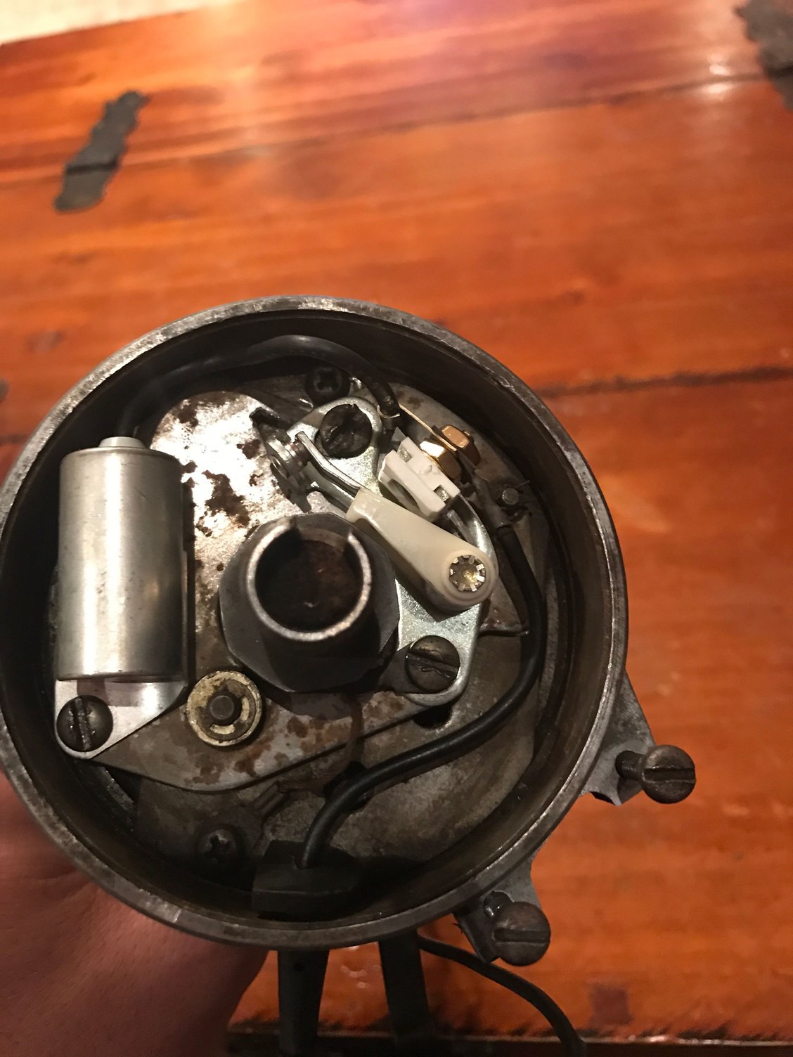

The distributor needs all that plus vacuum advance, the three Plastic buttons on the breaker plate are broke. The wire coming out is loose, and there is a good 1/2 inch up and down play on the shaft.
should I spend more and fix what I have or buy a hei setup. I don't have the money to spend on an expensive one, anyone have luck with the ones from amazon or eBay that are less than $100? This is a amateur daily driver build

Is the up and down play normal?

Sounds like a basket case to me. You'd do well using it for a core to use on a trade in for a fresh reman unit from the local parts house. I'd also invest in a Pertronix Unit to replace the points and condenser. That and a flamethrower coil to match. Points are nothing but trouble. But if you do decide to keep the points, you need to invest in a dwell meter to set them correctly. The point gap is only a starting point. The dwell setting is the most important thing to get set. If the dwell is off then so is the tune.

Points and condensers worked fine for decades, they will still work fine today. The trick is, they won't work well at all in a clapped out distributor. And there's lots to go wrong in an old distributor. Breaker plate, vacuum advance, and more.
Remember they are a strictly mechanical device. Virtually any side play or runout in the distributor shaft and bushings will cause problems with points. Most of them are worn out after 50 or 60 or 70 years by now. That's why everybody loves the drop-in spark modules, they aren't effected by shaft wobble.
However, even if you go to a Pertronix, you want a fresh, rebuilt distributor. Trust me on this.
