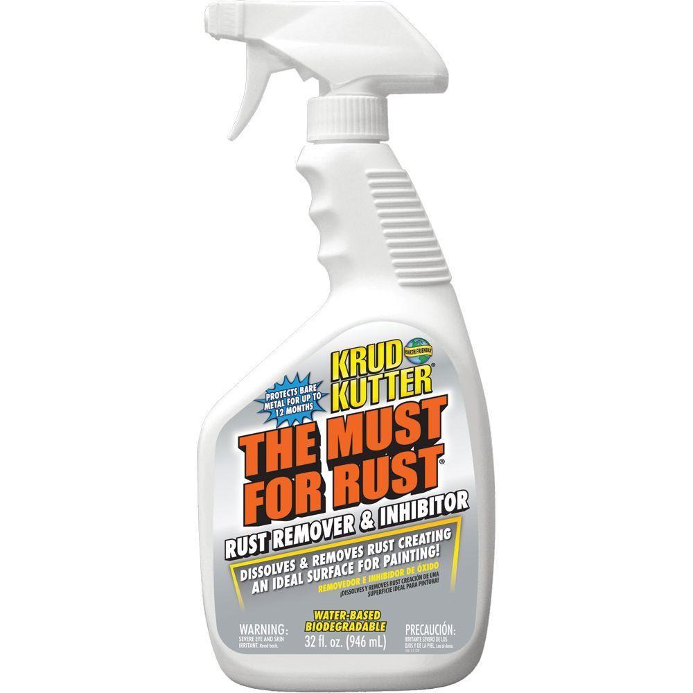

Home depot sells a product. Krud litter, "the must for rust". Works really good. I used it on some parts of my truck where I was leaning on bare metal. Works fast and prevents rust and can be painted over with no issues they say.

The roof on my '37 Buick was sun bleached and pretty much stripped of paint for who knows how many years. It had deep pitted rust but on such a large piece of sheet metal I didn't want to blast it for fear of warping it. I used what Chad suggested,
It has phosphoric acid in it. It worked great, got the rust out of the deep pits, you could see clean metal in the pitted metal. I used a stainless steel brush to agitate the solution and keep it wet.
