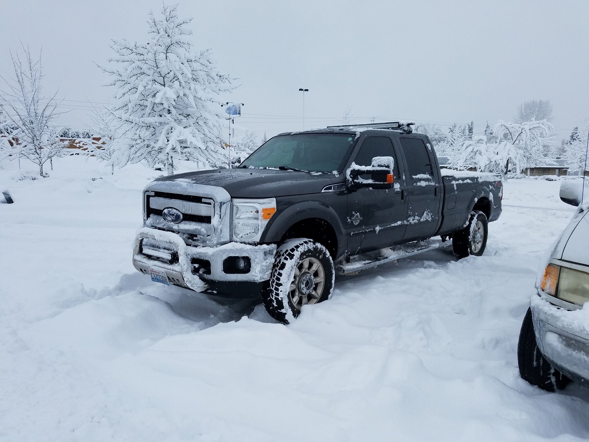

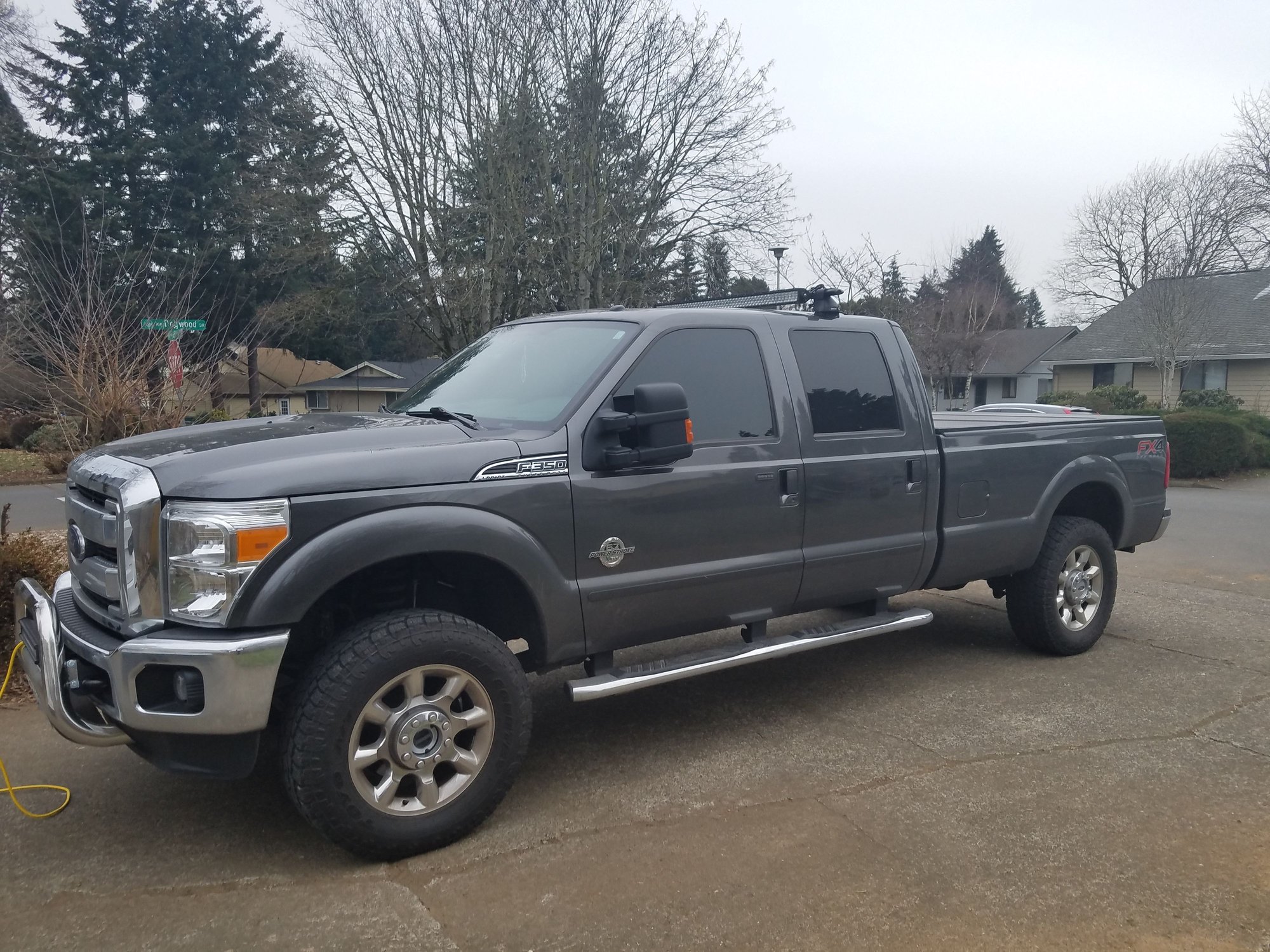

Have a 2015 F350 6.7 Powerstroke and as a leveling kit with 295 65-20 Toyo at2 extreme tires no other modifications my question is what should I be getting for mileage per gallon when I first got the truck I was getting 18 now I'm about 15 to 16 on put greatly appreciate it thank you..

Winter Diesel and colder temps will have the effect on mileage that you described. I wouldn't worry too much about the mileage until winter Diesel is no longer being dispensed, and ambient temps stay above 60°. If your mileage is still lower than previously after those two things have happened, then you could be concerned.

One thing hurting your highway mileage is that light bar or "sail".
If you haven't adjusted your IC to reflect your new tires size that also throws it off. Even hand calculating, since the # of miles you drive will be lower with bigger tires.

I ran 50,000 miles with the Toyo 295/65R20 A/T2 tires on my truck. It also had the 3.55 rear end and was leveled.
A good hiway drive, I might hit 18 mpg. Most of my driving was 15 Towing it's 10-11 mpg
I'd say your truck is right where it should be for mileage with those tires and lift.
I've been biting my tongue on this one. But Dak is 100% right. I was looking at roof racks for the wife's car to carry kayaks and all the eco greenies were bitching about a 1-2 mpg loss just with roof rack crossbars.
If you want mpg, remove the bigger tires, lightbar, and leveling kit. It's that simple. That said my dually will usually only get about 16 at best on the highway empty. But it easily weighs in at 9k and I can't do 65.
