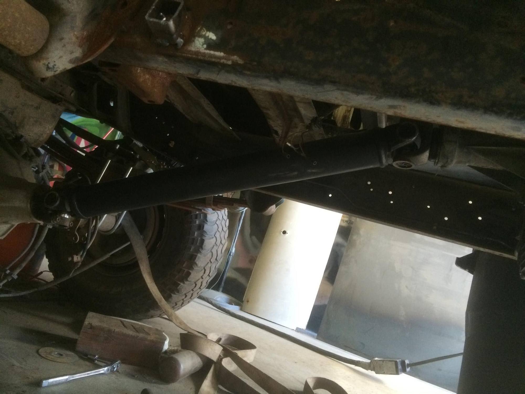

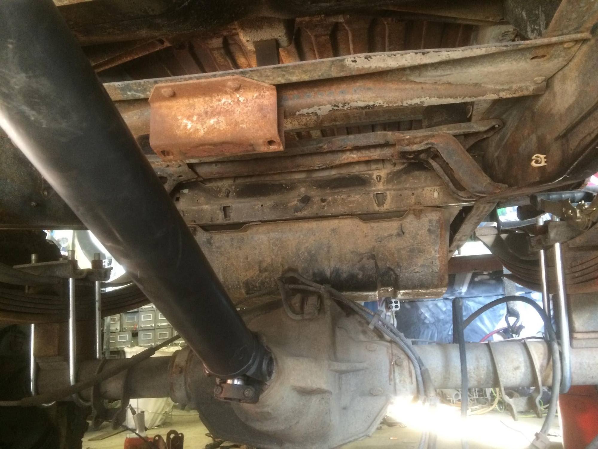

lots done today.
brake and clutch pedals installed
rear driveshaft installed
econoline steering column shortened and ready to get mounted.
I was anxious to get some shiny parts on,
shes getting closer!!!

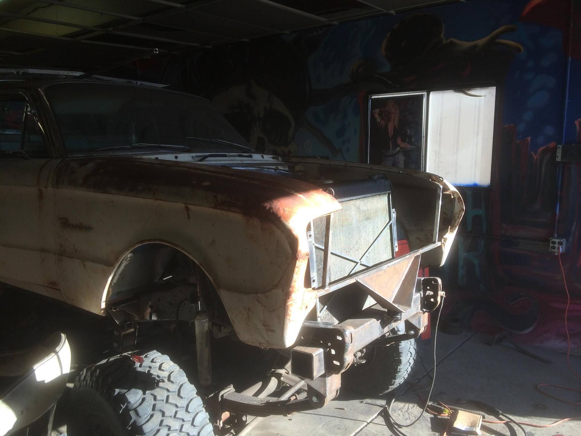

She sits a bit high lol
Old Feb 23, 2017 | 08:11 AM
  #37
IDIoit's Avatar
IDIoit
Joined: Apr 2015
Posts: 1,264
its only 36" at the rocker height

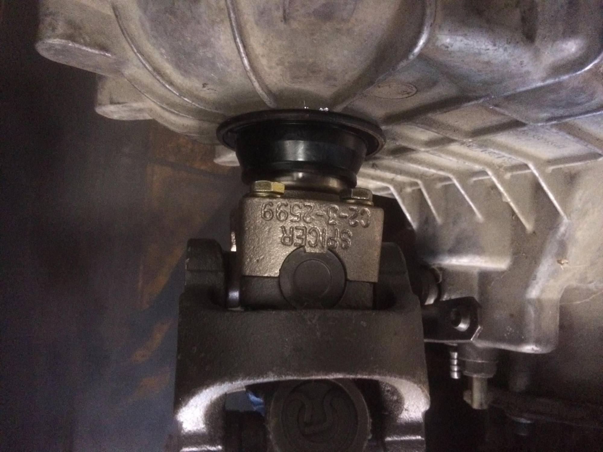

try finding a 1330 CV front output shaft for a BW13-56...
this has been a nightmare for a few weeks.
but its finally in, and shafts are done.... for now

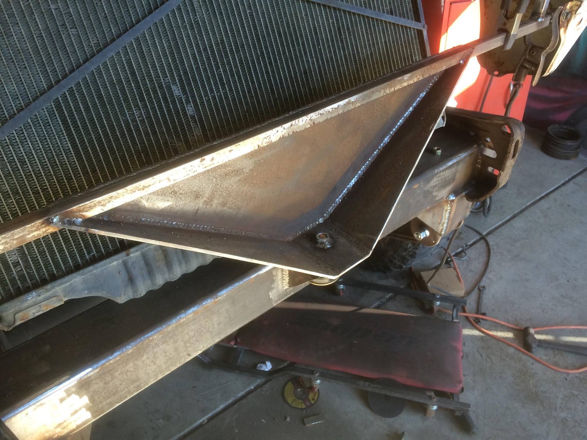

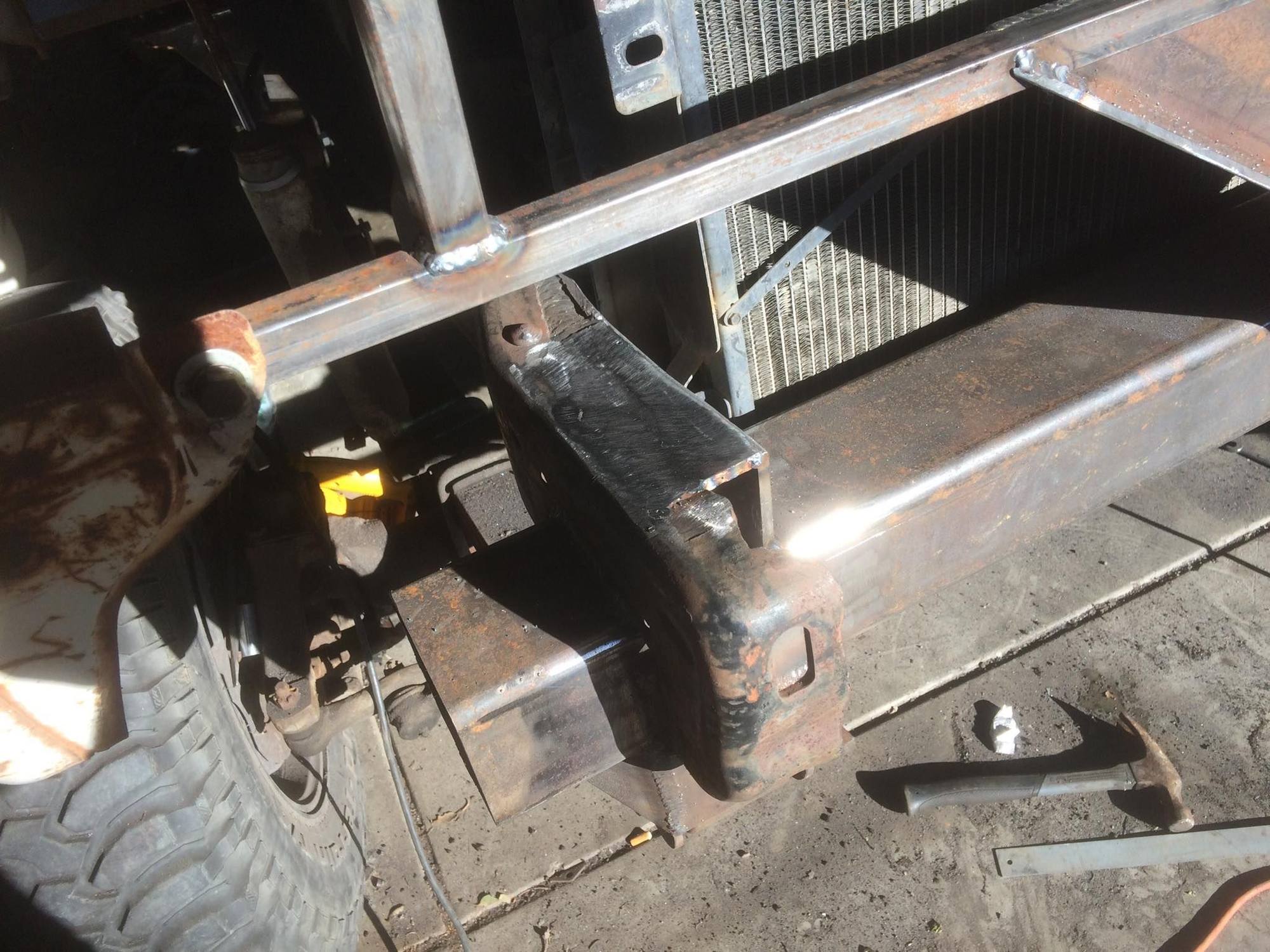

I plated the front of the frame to the 4x4,
and installed studs on the frame for the radiator.
still gotta make a mount for the radiator but...
minus the floor and the dog house, the major fab work is done!!!
I take that back, I still have 2 more intermediate body mounts to do.
