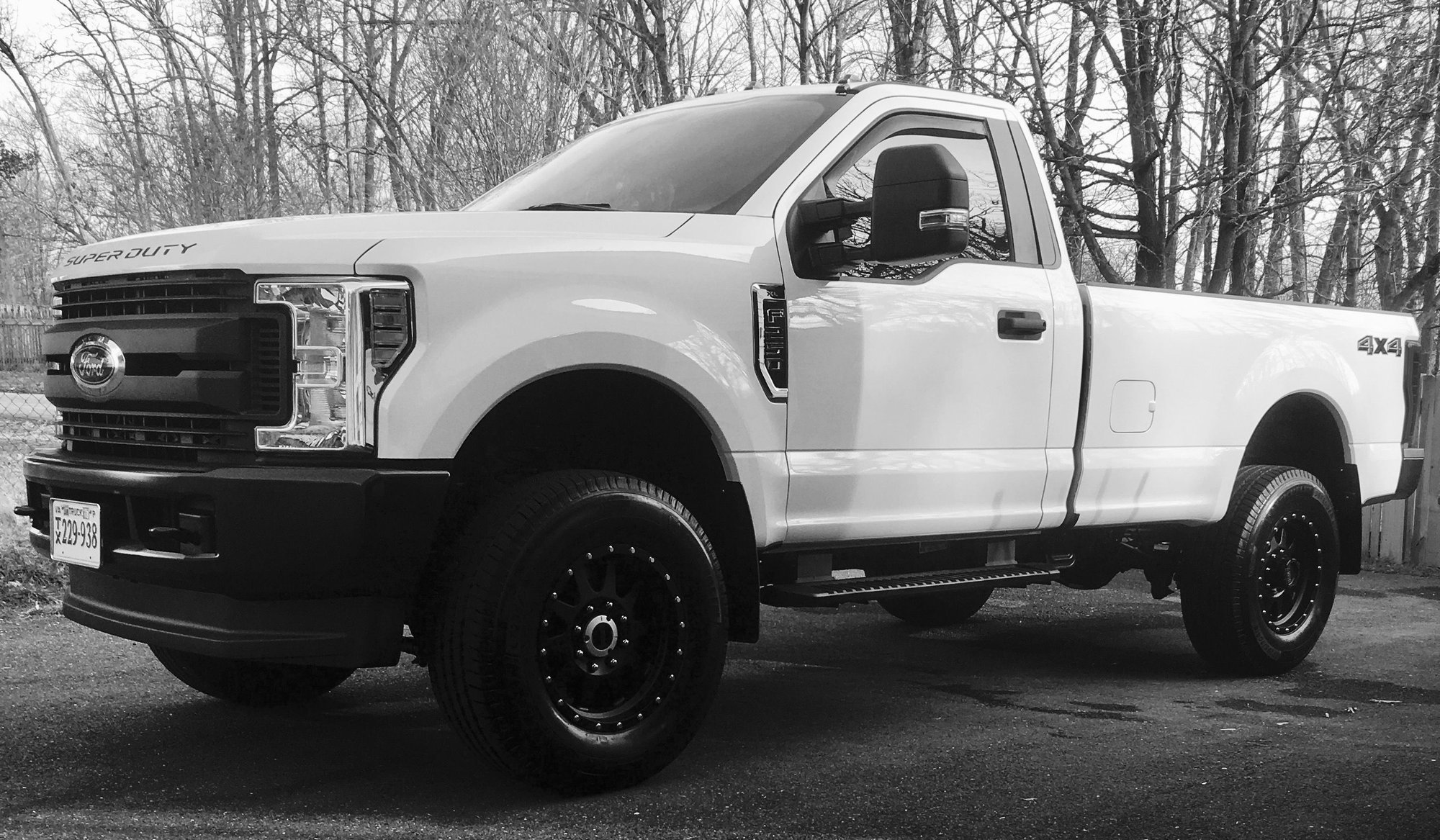

I have the Ready lift 2.5 on mine. It came with bump stop extensions and sway bar mounts and brake line extensions. I noticed my wheel sticking out farther on the driver side as expected so I ordered the track bar relocation bracket from readylift also. The kit from them is only 249 so I would say just get the parts to do it right and keep your truck riding great. Here's a pic with the level. It still has a rake, this pic is on a sloped driveway.
