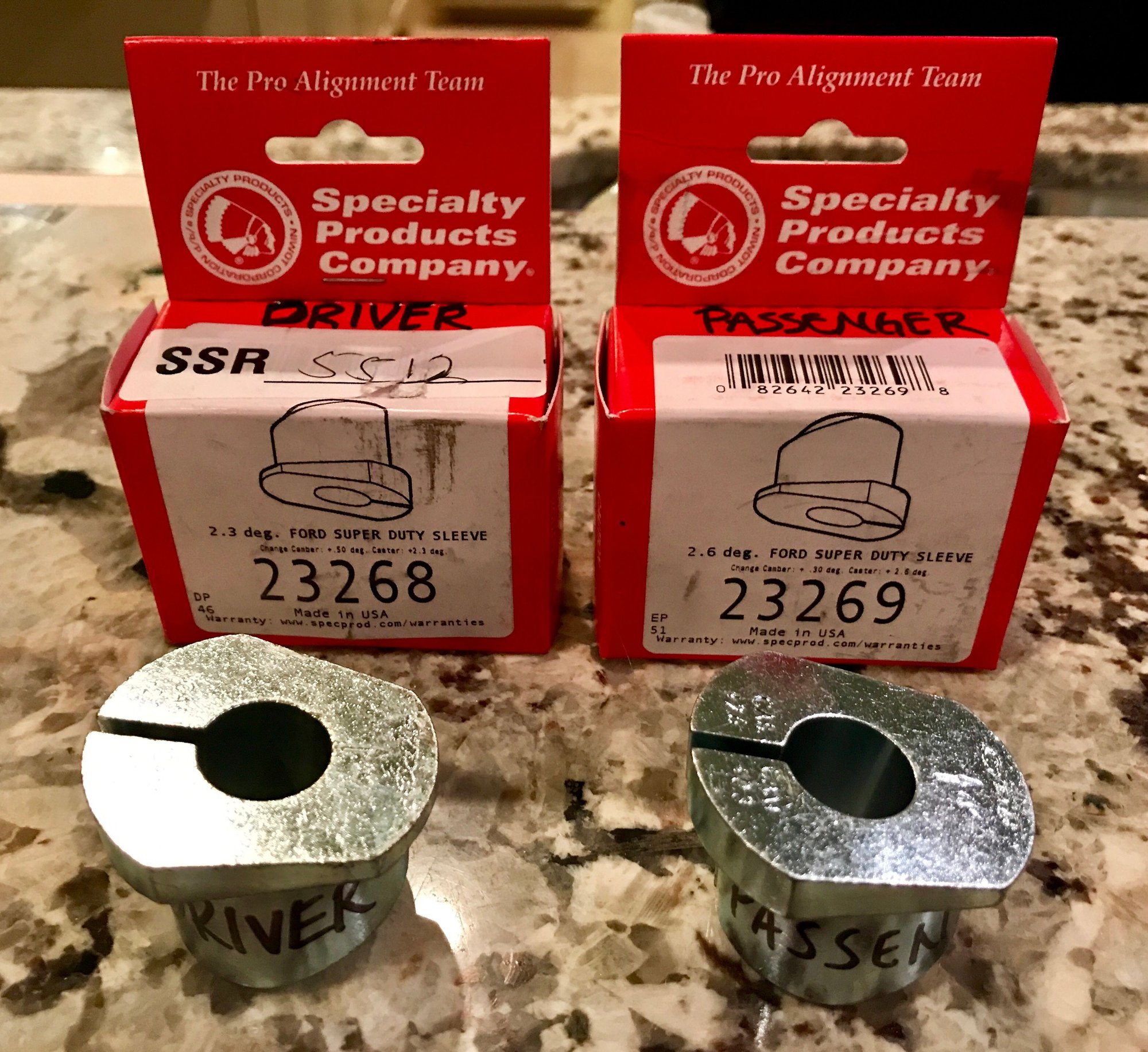

Anyone that says you don't need the caster shims is fooling themselves. I only have the 1.5" rough country springs and the truck was noticeably floaty even when not towing. It wasn't dangerous but quite a departure from stock. I went with the SPC shims (23268 Drive, 23269 Passenger) https://www.spcalignment.com/index.p...tion&pid=23268
