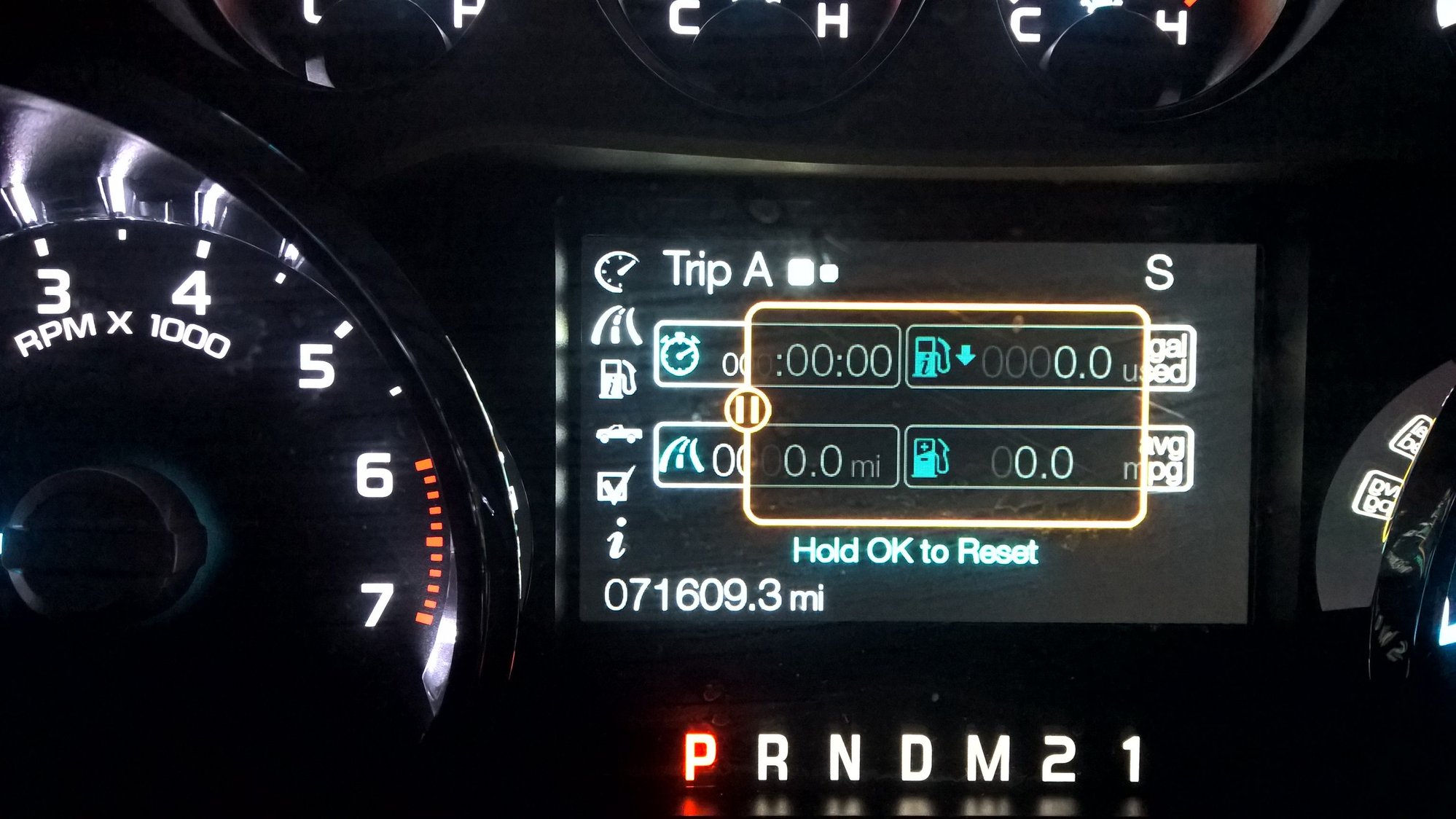

Does anyone recognize this display and how to correct it? Although you can see the underlying information in the picture, you can not see through it in real life. The rectangle is dark and the data below it is blank. The trip information doesn't work. It started on the Trip A screen several months ago and now has started on the Trip B screen.

Not sure, but first thing I would try is unhook the battery for a bit to reboot everything. Might as well try the simple stuff first in case it works.

The display is PAUSED. Press the OK button to UN-PAUSE it.

I had mine do the same thing. Just hit the "OK" button on the steering wheel and you are good to go
