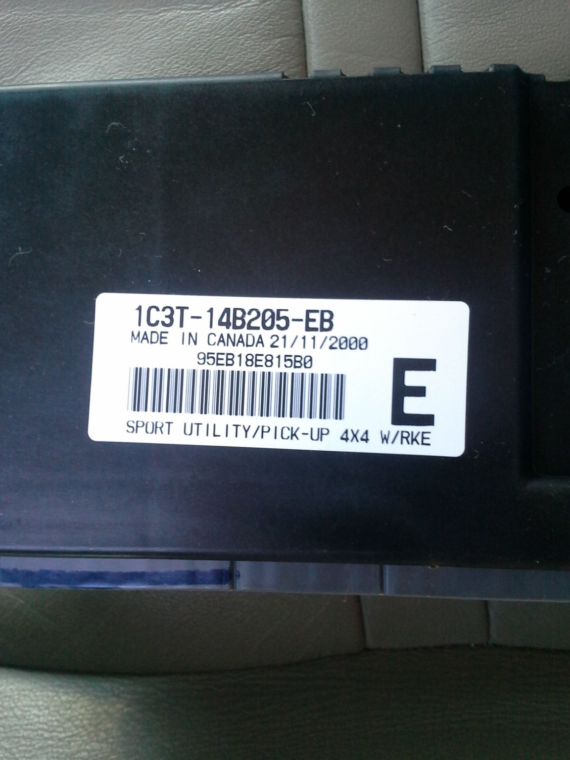

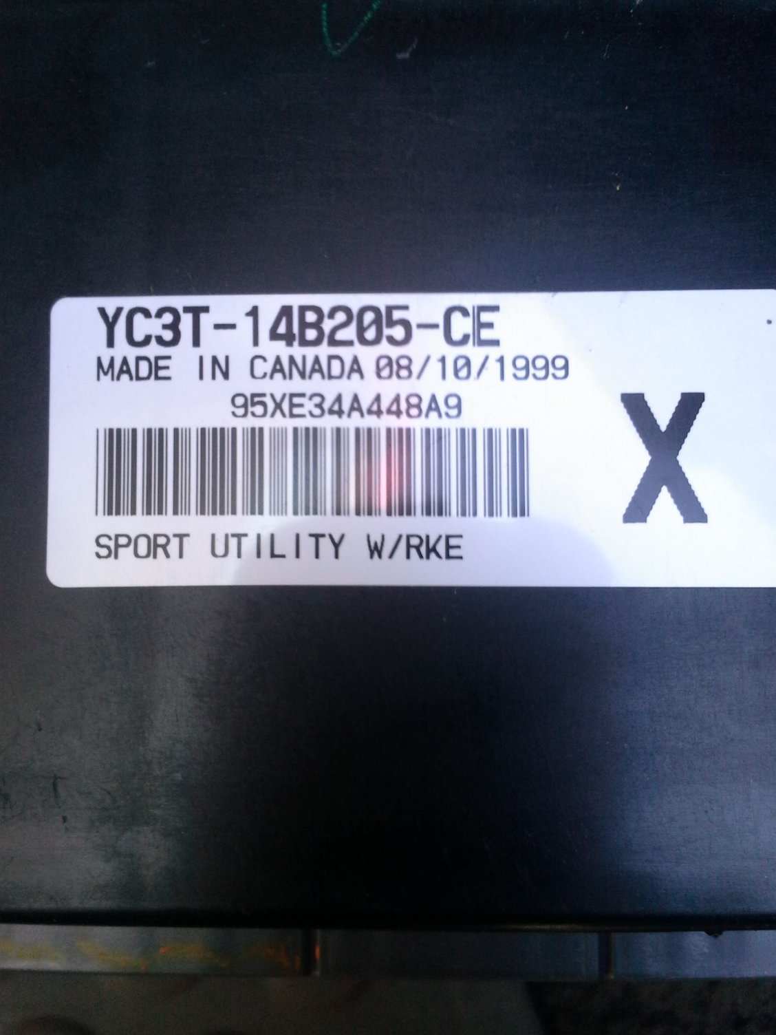

From: Western AR
The 99 trucks have a GEM module. You will have to get a 4x4 enabled GEM module before using the ESOF features you are after. All 4x4 functions are routed through the GEM module mounted on the back of the central junction box by the driver's left knee. The GEM modules in the 4x2 trucks DO NOT have the software/hardware in their GEM modules to control 4x4. There is a sticker on the back of all GEMs (sandwiched between the module and the fuse box) that tells you what capabilities it is loaded with. Examples of a 4x2 Excursion and 4x4 Excursion:
2001 Excursion with 4x4. RKE=Remote keyless entry
2000 Excursion without 4x4. If I put this in my 4x4 X, I will lose the 4x4 capability, but everything else will work.
