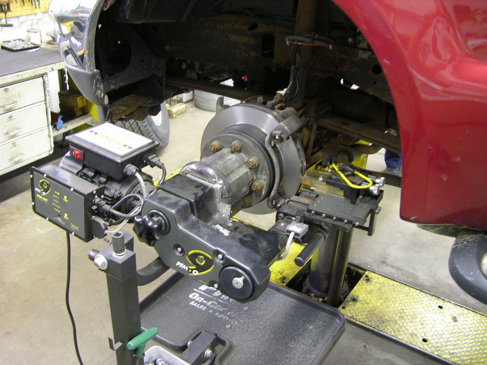

25 years testing brakes, a few thousand tests (like 10,000), and using measuring equipment that cost what a new King Ranch costs today never showed a rotor heat warp. Showed them wear unevenly, especially when installed with a higher runout then spec'd. There's a lot of new aftermarket rotors out there that don't meet runout spec and won't come in with indexing.
Rotors can be turned and work fine. They need to be turned on the vehicle with an on-car lathe to maintain the proper runout. Often you can beat the OE spec. Bench turned rotors, not so much. And if they already have developed cementite they can never be corrected. Learn that lesson enough the hard way and you won't bother turning rotors ever again. It comes back to bite in 5-10k miles and makes you think they heat warped. They didn't. The hardened area doesn't wear the same so back to the disc thickness variation just like a high runout rotor.
